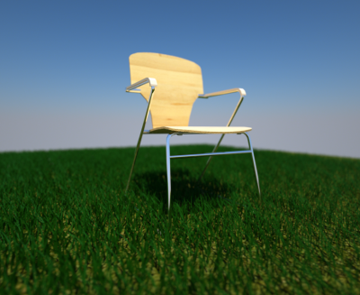

Paul I love you :lol: :lol:
(This is a real placement of one of my projects!!!)
Make the generator its a bit tricky... I put the object in the 0,0,0 and then works perfect..

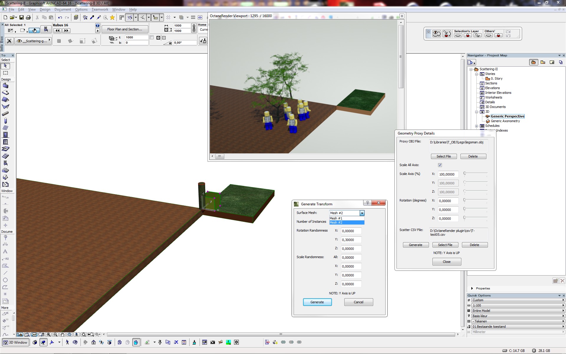

Hi Paul,

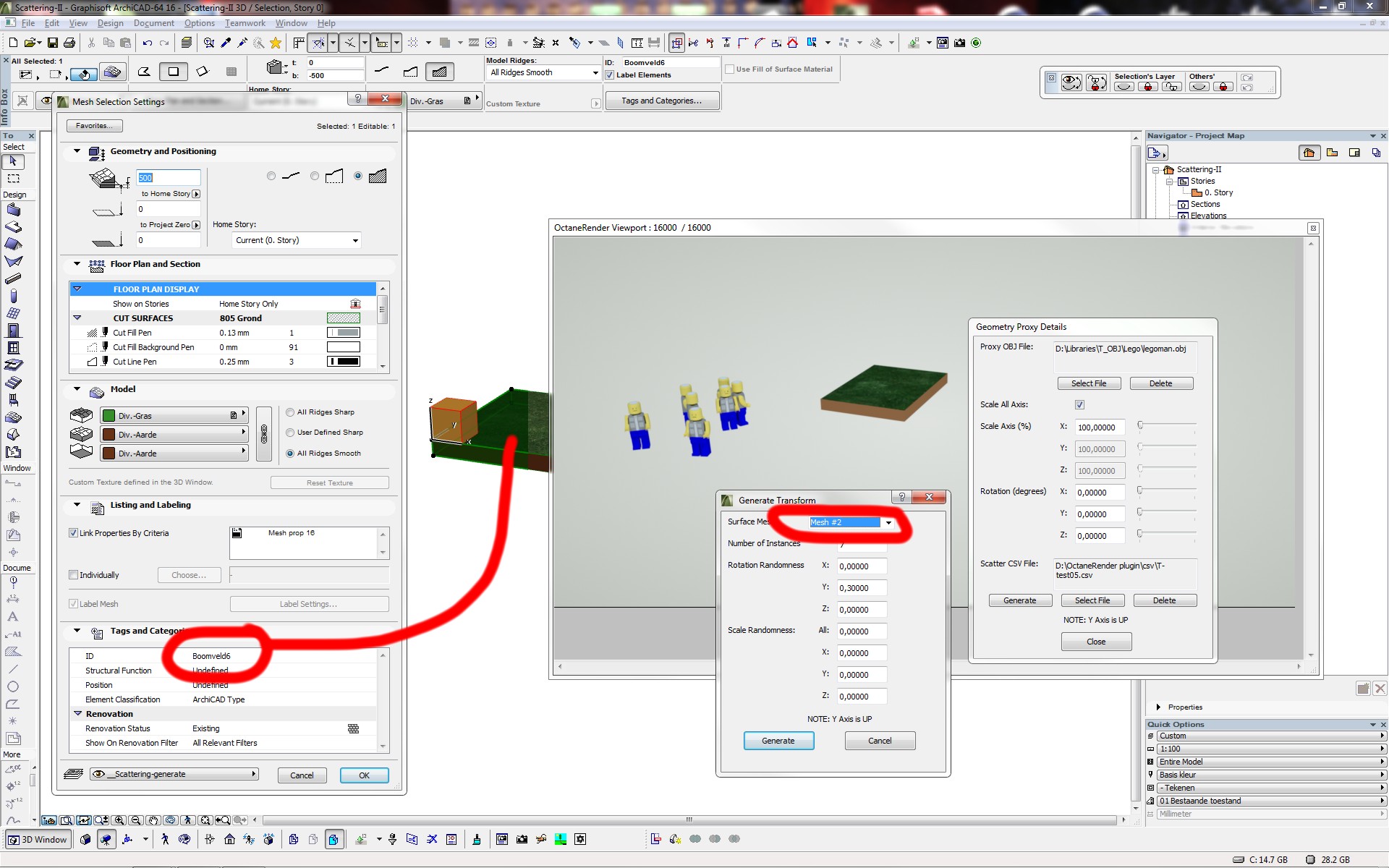

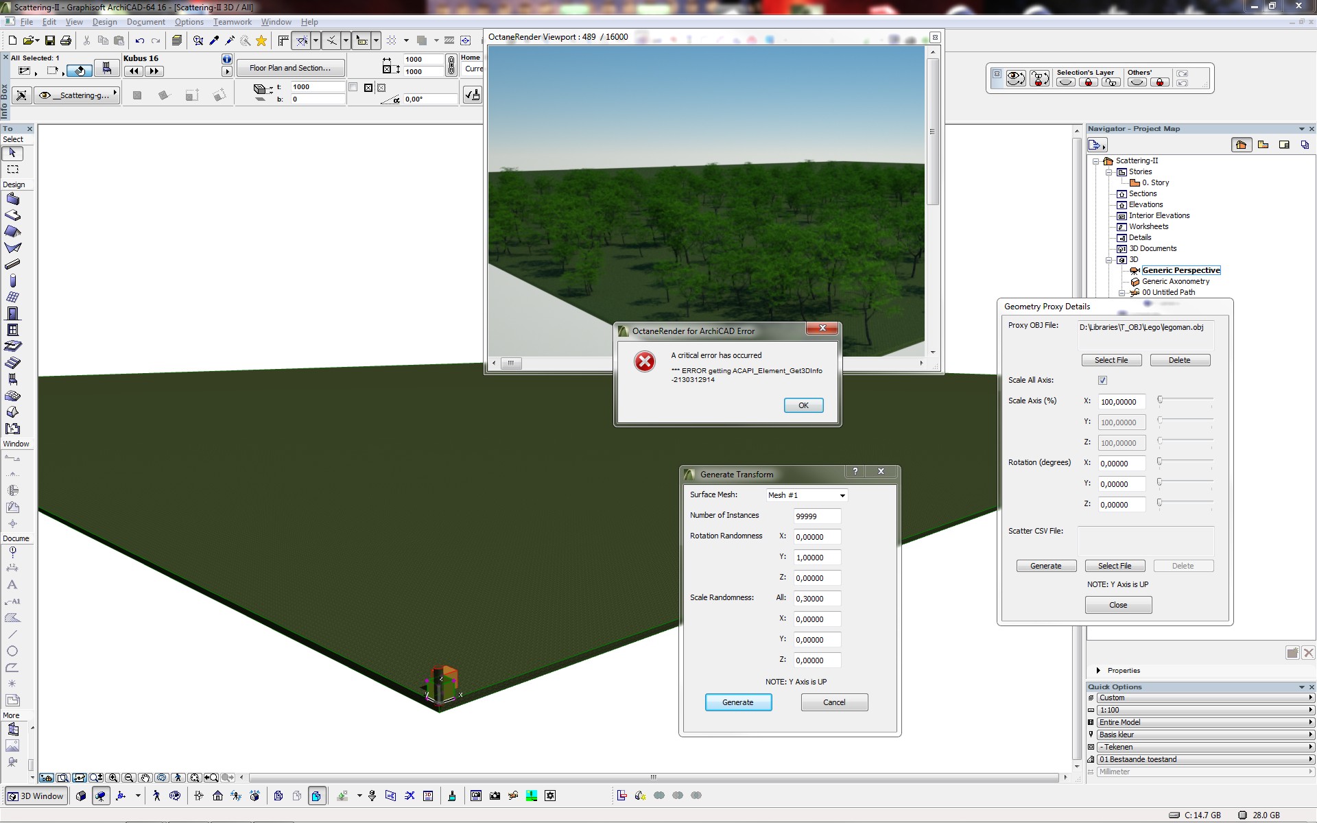

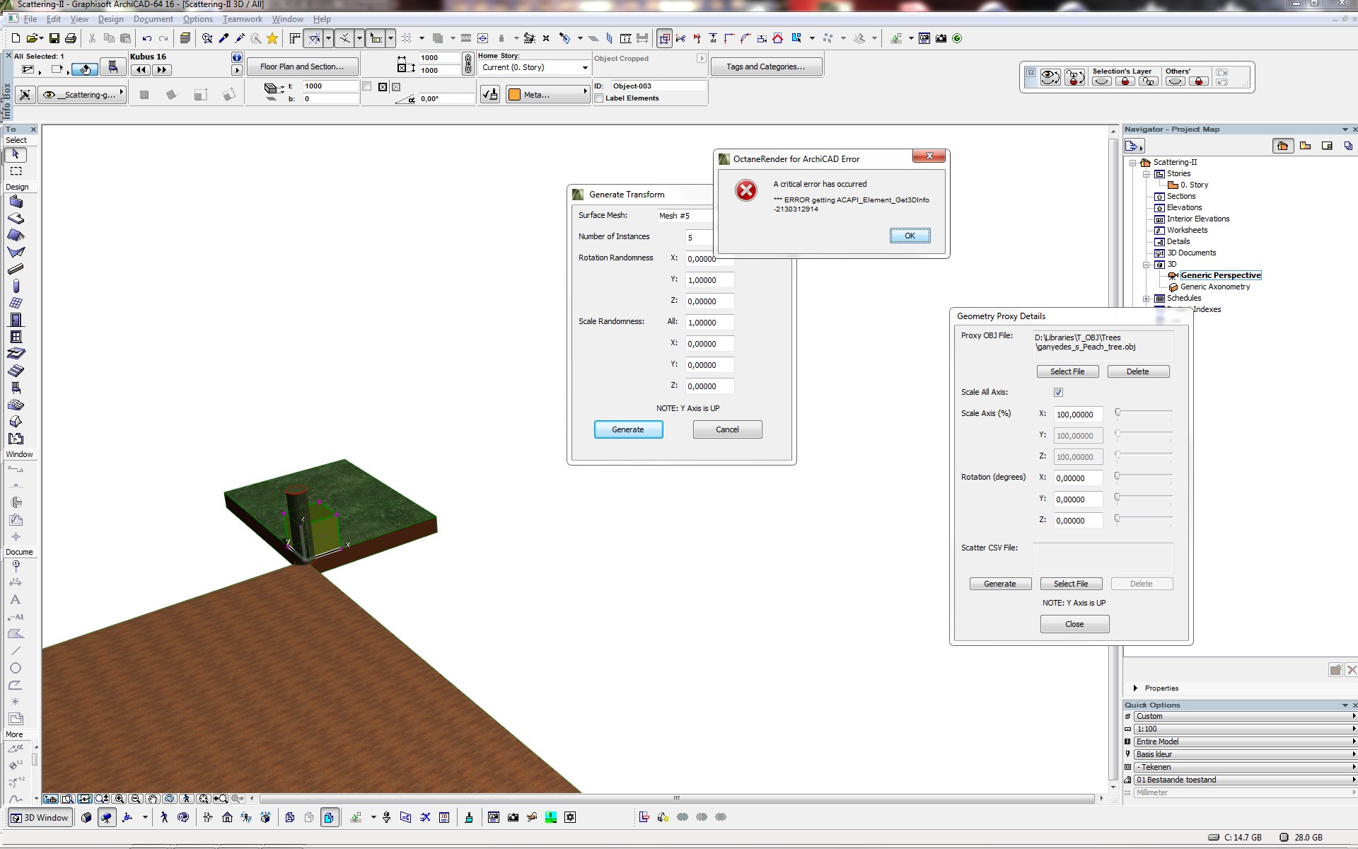

I did some experimenting with the scaterring and it is a blast :!:
I love to experiment with this and I have encountered the below:
At first I placed one mesh and succesfully did some scattering. Then I deleted the mesh used for scattering and tried some more with new meshes, but I got errors.
I started a new pln form scratch made two proxy (tree and legoman) and i made two meshes I want to scatter on. I can only scatter on the first mesh made and I cannot select the other mesh.
I even could not do the scattering on the specific mesh when viewing only the proxy and the one mesh.
I also renamed the ID of a mesh (my example is boomveld and it makes boomveld1, boomveld2, etc..)
it would be nice to have these names to slect for the scattering?
greetz, Jeroen

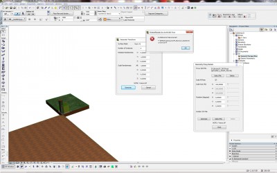

Hi Paul,

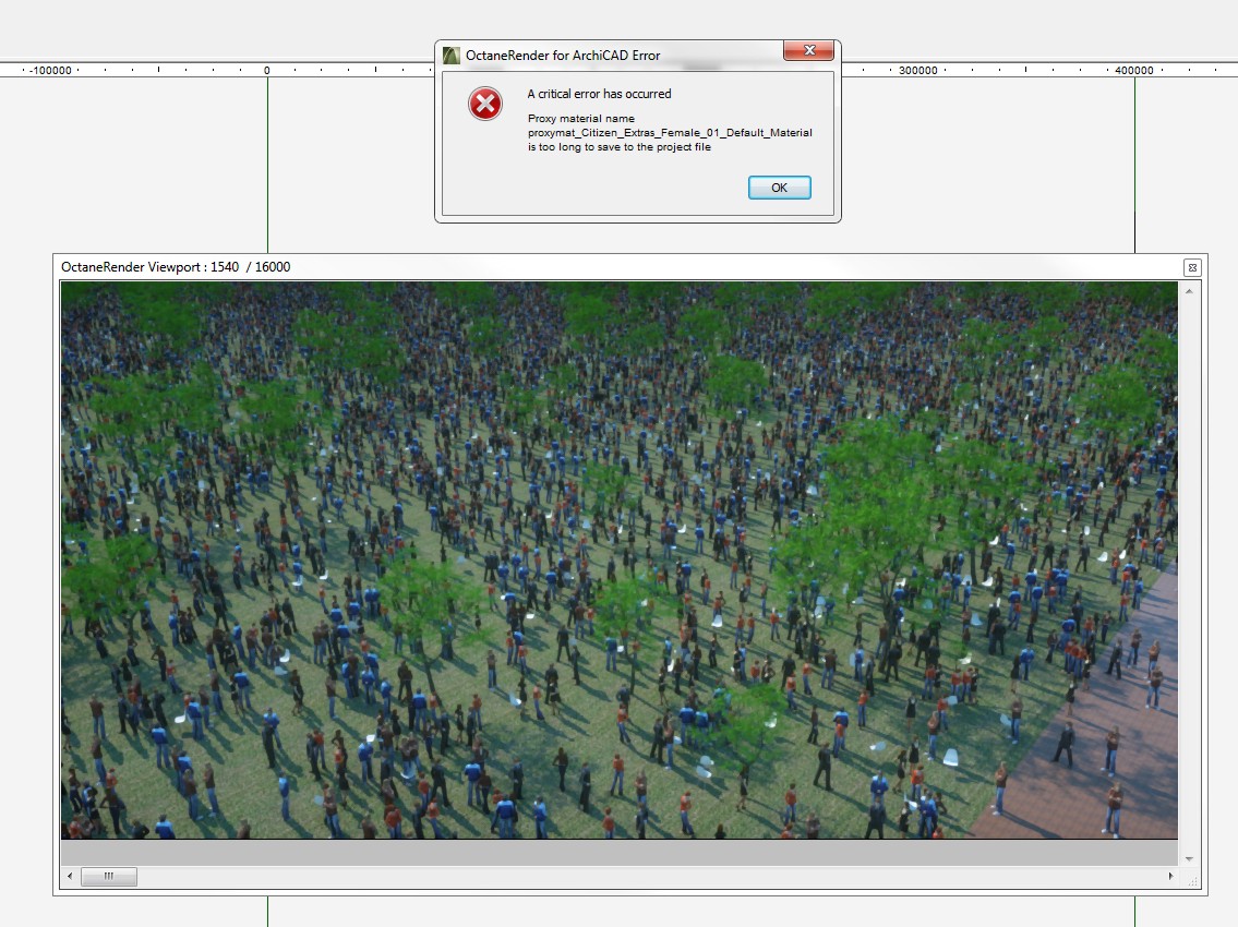

I got this error, but cannot recall how I got this.
Below you can see an event with 60.000 people :D
A lot of people went to the same store to buy their jackets :mrgreen:
When trying to save the pln I got the error a too long name for saving.
This is a bit of a pain, because it might be a lot of work in future to rename a lot of objects?
I'll try more OBj's in my library to see of this occurs a lot.
greetings, Jeroen
