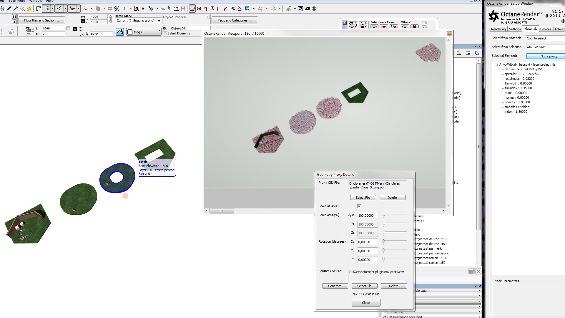

Great to see the scattering works also on non-rectangular meshes :D
Wholes in the meshes is not possible. Yet :?:
I notices when assigning proxies to the meshes (wuith wholes) it firstly misplaces the proxies,
but after refresh geometry it corrects itself to the rigth place.
greetings, Jeroen
Hi Paul,
In additon of this issue I tested to see if I could work around easily when having wholes and if it will not be possible to scatetr meshes with wholes: I cut the round mesh in half to see what it does when scattering the m seperately. The strange thing is that one half does it correct and the other half scatters in the whole where it should not. Just wanted to let you know.
greetz,
There is some complex code to detect holes in meshes in ArchiCAD, and I thought I would simplify the "scattering" routine by ignoring the holes, but clearly that will not work :-) I'll look into this.
Paul
face_off
Posts: 15773
Location: Adelaide, Australia
I have looked into this some more. I wonder if your issue is that the OBJ geometry is not centered (ie. 0, 0, 0 point of the OBJ is not at the centre of the OBJ mesh) - so it is appearing offset. I have a grass patch OBJ, and 0, 0, 0 is at the far left, meaning the grass is offset to the right when rendering.
Also, I noticed if you create a mesh with a hole, then create another mesh in the hole, they both get the same ID, which confuses the plugin. In this case, manually change the second mesh ID.
I have found a small issue, which I will post an update for, which may resolve some of your "proxy info not saving" issue.
Paul
