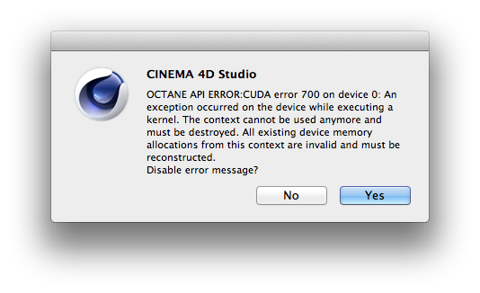

Keep getting this error message. See attached Cuda error.

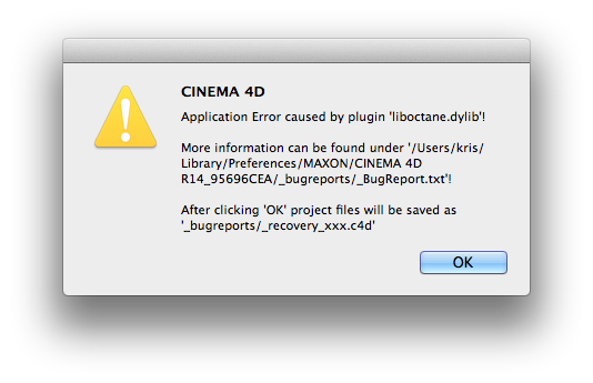

Other issue is C4d keeps crashing when idle. See attached App error.

App Error
App Error
Cuda Error
Cuda Error

i'll check about the idle crash, maybe it's also related to the priority, there is not enough gpu power for other applications :roll:

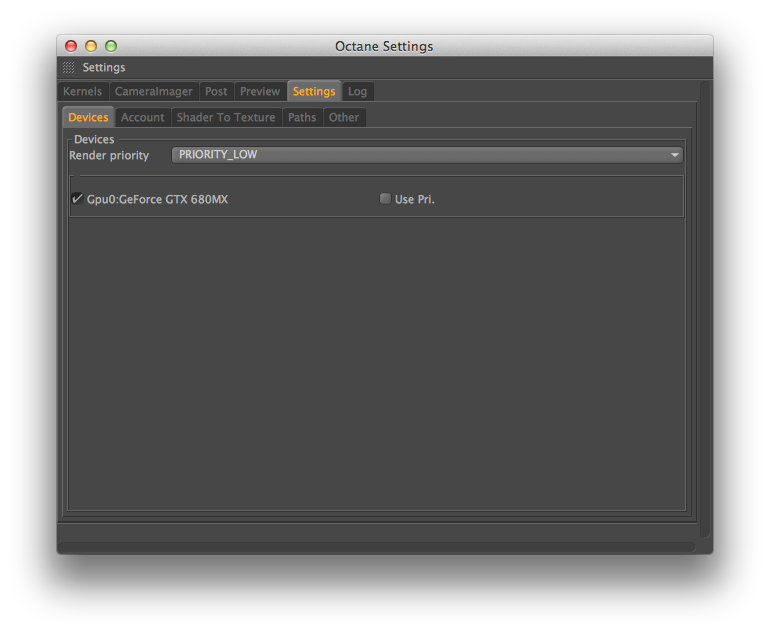

Hi thanks for replying bepeg4d
See attached settings screen grab.
These are the settings Ive been running - which are the default – Should I be doing something different?

yes, you should try to activate the "use pri" checkbox at the right of the gpu, in this way you activate the priority option for that particular gpu and you could choose different priority with the popup ;)

thanks for the help mate appreciated :-)

The priority has solved the performance problem. Thanks for that :-)
Still having the crash when idle. Seems like its just me though. Weird.
