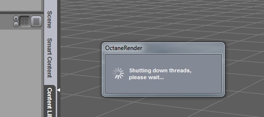

Anyone else getting a hang when exiting DS from the last upgrade of OcDS. DS 4.5.16
This screen sit for more than 5 min and never goes away have to kill the Ds process.
Lockup Screen
Lockup Screen
t_3
Posts: 2871
Tugpsx wrote:Anyone else getting a hang when exiting DS from the last upgrade of OcDS. DS 4.5.16
sadly a lot ppl apparently; on various occasions, when starting, loading, closing. the (single) reason is identified and i'm currently working on the fix. should arrive within a day or two (if all goes well, etc.) together with another fix for animation rendering, and a fix for the disappearing material links...
