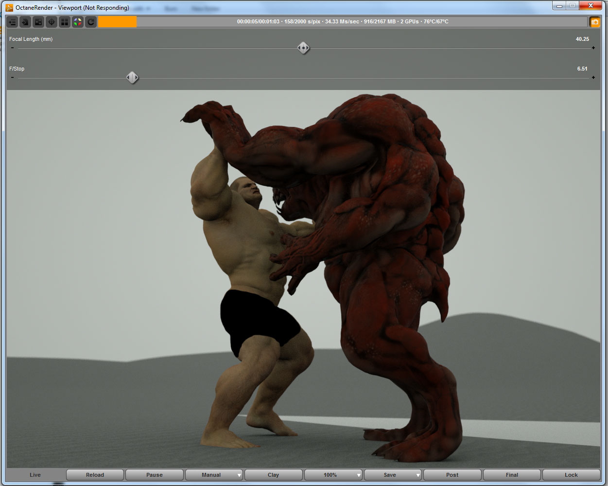

I had a crash after changing my environment to default HDR & browsing and testing thru the available options. DAZ let me write a zipped report but lost all my scene. At least I could screencapture my image which I'm enclosing (and painting black pants to the human character for modesty). Only one Genesis Freak 5, one Poser Sixus creature and Flipmode desert sands environment. I was trying to find out how to change my sky since Flipmode's dome wouldn't render. If there is a place I can upload the crash report I'll be happy to do it.
Edited to post that I've read in the forum that I need to send report to support[at]octanerender[dot]com, so report sent.

SimonWM wrote:I had a crash after changing my environment to default HDR & browsing and testing thru the available options. DAZ let me write a zipped report but lost all my scene. At least I could screencapture my image which I'm enclosing (and painting black pants to the human character for modesty). Only one Genesis Freak 5, one Poser Sixus creature and Flipmode desert sands environment. I was trying to find out how to change my sky since Flipmode's dome wouldn't render. If there is a place I can upload the crash report I'll be happy to do it.
thanks for the info. had you already changed the nodetype of the texture pin once before this happened?

Honestly, I don't remember. :oops: I was going thru the options and I know one crashed it but don't remember which one.
32 GB of RAM, Sabertooth x79,Intel Crest 180 GB SSD system drive, WD Caviar Black 1TB, i7 3930K CPU,
CoolerMaster Haf 912, CPU Cooler Master Evo fan, Windows 7 Pro SP2, Corsair AX1200 PSU, EVGA GTX 580 3GB Classified Ultra, EVGA GTX 580 3GB Classified
t_3
Posts: 2871
SimonWM wrote:Honestly, I don't remember. :oops: I was going thru the options and I know one crashed it but don't remember which one.
well, it is not completely unlikely that it happens again; so my smiley would also be this one: :oops:
