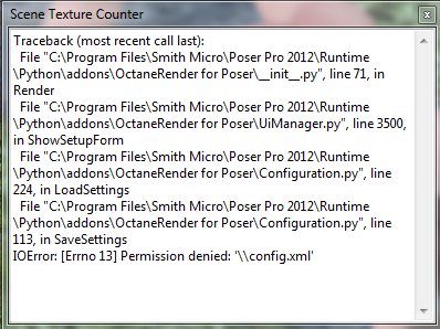

I downloaded the latest version and got an error. Happens when in Poser when I select render/octane render. It the 1.14a5 version. So, now I can't render at all. Great!!!!! Now what????
octane error.PNG (53.43 KiB) Viewed 5767 times
Gateway i5 3.2ghz, 16g RAM, GTX 690 4GB VRAM, Windows 10 64bit, Poser Pro 11, DAZ Studio Pro 4.9, Daz Octane Plugin V2, Poser Octane Plugin V2

To get up and running now, run Poser as Administrator. I will have a fix in a few mins.
