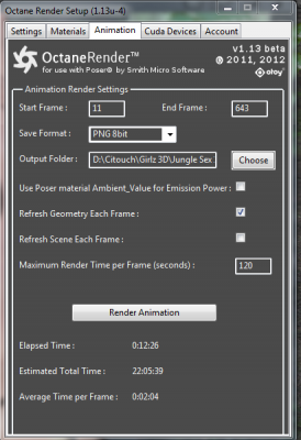

Yep, direct Light did the trick. Much faster, and great quality. BUT....... Now I am rendering a 650 frame animation. Set to 120 sec per frame render time. After 2 frames it stops rendering. The first time it happened got an error message that GPU has stopped responding. Started it again, and after 2 frames just stopped, as if I has paused it. Could not access the reset button for the card. Had to csncel render, close Octane render window, and restart the Octane render. I am using the latest plugin, 1.13 test release. Is it a bug or is something else going on? Thanks.

Hi Morph
This has been reported before, and appears to be a card hardware fault. Slightly underclocking your video card generally resolves the issue. There will be a card utility on the CD that came with your card - just drop the clock speeds a notch or two.
Also, after this error happens you will most likely need to restart Poser in order to ensure all buffers etc have been reset correctly (Resetting the card seems insufficient in this case).
You can check you Poser temp folder and there will be a cuda.log file which will give more details. You can also click the "Show Log Button" in the "Cuda Devices" tab. Can you post either log pls? It might give me a better insight into what is happening.
Also, can you post a screenshot of your plugin Animation tab settings pls.
Paul

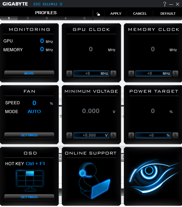

My card comes with OC Guru II, but in the interface, it shows the clock speed as 0 and I can't change it. Is there another utility or is this card not capable of underclocking? On the box, it does say it is the OC version. I emailed nVidia and told them i need instructions on doing this procedure but have not heard back from them. Any other ideas? Thanks.
