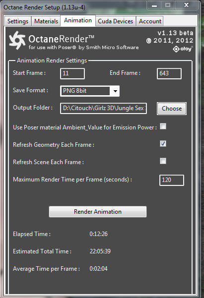

Also, can you post a screenshot of your plugin Animation tab settings pls.

Here is the animation tab. Could not find cuda log.

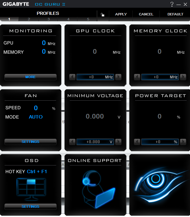

My card comes with OC Guru II, but in the interface, it shows the clock speed as 0 and I can't change it. Is there another utility or is this card not capable of underclocking? On the box, it does say it is the OC version. I emailed nVidia and told them i need instructions on doing this procedure but have not heard back from them. Any other ideas? Thanks.
