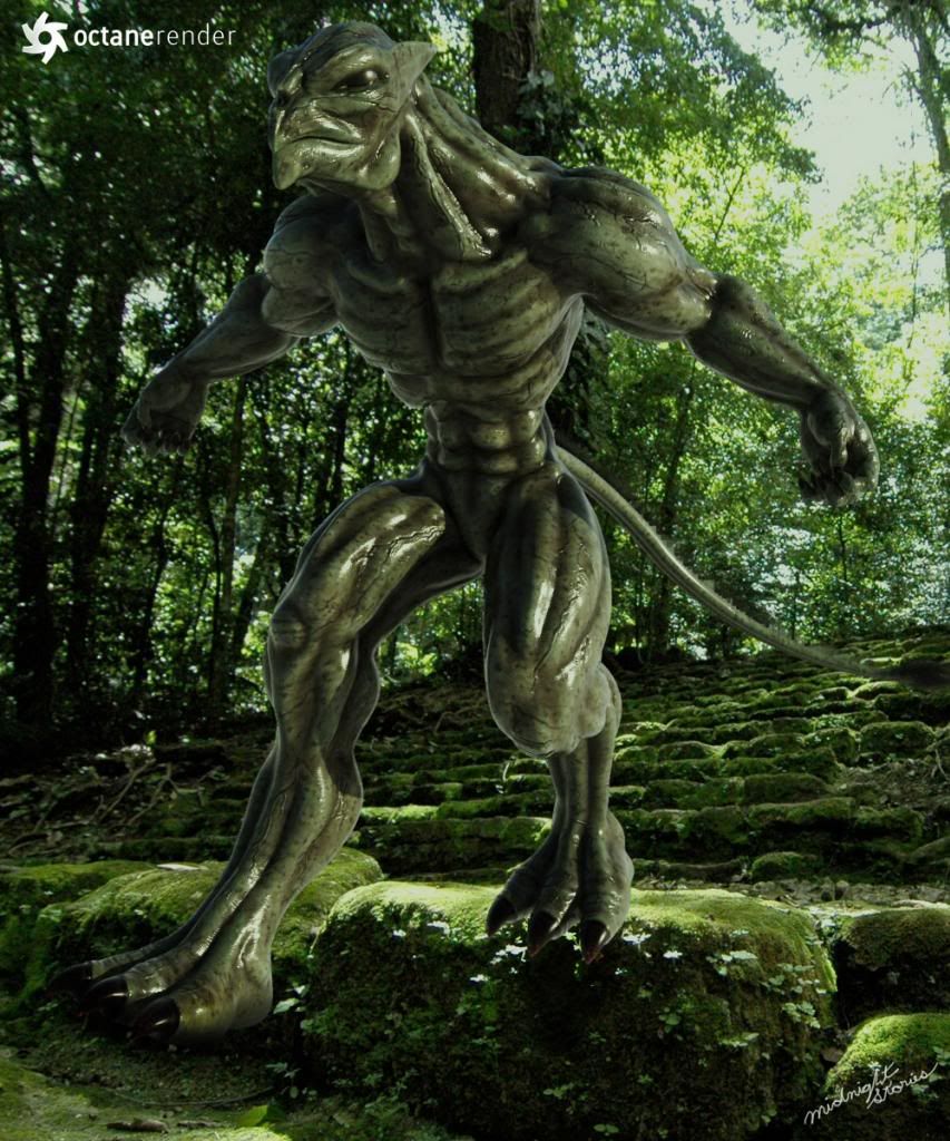

I guess as I bought it today I assumed that the download would have the latest update, so is there updates posted here? I'm pretty new here.
Love the Daz plugin way more than the poser one very well integrated.
Have a few renders today, as soon as I replaced the displacement maps with normal the details started coming out.
So will be looking forward to the update and I'll waiting for that.
Thank :D

that looks really wicked

Thanks !
I had to convert him to Sub-D and go to the highest level to get the smoothest render and the normal maps helped a lot.
There a new program free at the moment for converting displacements to normals.
Found here. https://www.knaldtech.com/

Hi Midnight_stories :)
Love the render, real cool ;)
Also, cheers for the link to Knald, just what I need .. Thanks for sharing here :D
