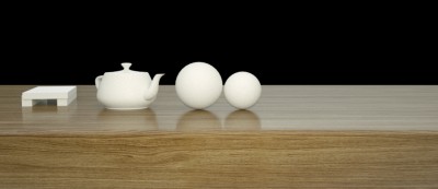

Hi Karba,
Here is another bug I've found. I'm not sure if somebody else said it.
If I use texture for bump on Glossy Material. The alpha of that object get a litte weird.
The first image is without the bump map. Value=0

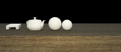

The 2n image is with bump with image imagetexture doesnt matter if its float image texture

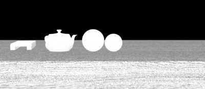

3rd image is the the alpha channel as you'd see.

I tried to reproduce crash with proxy with the file of "cfrank78" and do the same as in the video and have no problem, no crash.
But I also notice, sometimes, the problem of alpha as "oguzbir" report.
