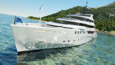

great job !!!but, i agree with the flags.. the simulations can be much better, and i think is not necessary the final shot with the island in the ocean ( not so real as the other scenes - reveals thats a CG image). great work anyway, good job.
No caustics?!!
But sorry you need ~4000-5000 or more samples to appear caustics.

pmc generates caustics...but not so much...
the sea is a sandwich made with the Dreamscape ocean object, a circular sea and a third circular plane that simulates the ocean's floor.
Because the Dreamscape's ocean id a trapezoidal mesh that adapts to the camera position you notice in the reflections this piece of geometry. Then the empty space must filled by another geometry.
This complex and large mesh generates caustics, If I delete the second circular mesh I get a caraibic effect, the sand must be positioned at -10 meters (the dreamscape sea object stays always at zero)
I will post a shot.
Regarding the flag I used and old simulation that I created 5 years ago into another cg animation (in that time I used vray)
I'm not an expert about the winds but when the scirocco wind blows you see the sea calm and the flag moves very fast.
Unfortunately Octane (now) doesn't support image sequence because I can generate a bmp sequence of foam that intersect the ship or the island beaches.
The ***REALLY BAD*** problem in this work is the exposure flickering.
Octane for Max now can't be used in Pro productions because the pmc kernel generates different exposed frames.
I used several brightness stabilizer in After Effects to reduce this issue, and several frames were deleted during the editing.
I could use the PT kernel but in this scene is impossible to use it because the sun and a very large reflective object....you can't believe how many fireflies generates the PT kernel with caustic blur set to 1.

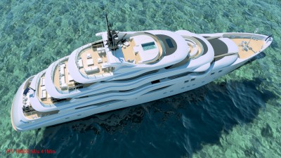

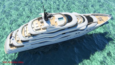

this example shows why we need no flicker in animations rendered with the pmc kernel.
It's impossible to use the pt kernel because it generates a lot of noise.
Also the pmc kernel produce faster and better results.
I used a caustic blur set to 0.03
5 bounces
parallelism set to 1
0,5 hot pixel remove
some photoshop retouch
the images were rendered with four GTX680
Compare yourself the two images
edit:
the last one image was rendered in "just" 36 minutes (pmc 4000M/s)

Yeah. But I keep no caustic blur (0.00) due to be more realistic.gabrielefx wrote:this example shows why we need no flicker in animations rendered with the pmc kernel.
Thank!the images were rendered with four GTX680
edit:
Not 4000 M/s but yes ~4 megasamples/s or total 4000 samples during 36 minutes?

oh yes 4000 samples/sec and not 4000 M
the animation was rendered with caustic blur set to 0.3 and not 0.03
quad Titan Kepler 6GB + quad Titan X Pascal 12GB + quad GTX1080 8GB + dual GTX1080Ti 11GB
4000 samples/s are too slow!? lol But yes probably 4000 kilosamples/s.gabrielefx wrote:oh yes 4000 samples/sec and not 4000 M
