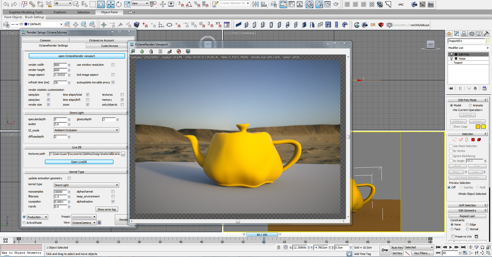

I realized this when I illuminate my scene with a HDR environment.
When I begin to render my animation with animated objects octane forgets HDR importance sample and sometimes HDR's gamma and rotation.
I try this with octane's viewport and there is no problem when viewport's first time. But if try to go next frame; same problem.
This happens only with animated objects or autoupdatemoveable proxy option checked.
Do I do something wrong ? or this is a bug?
