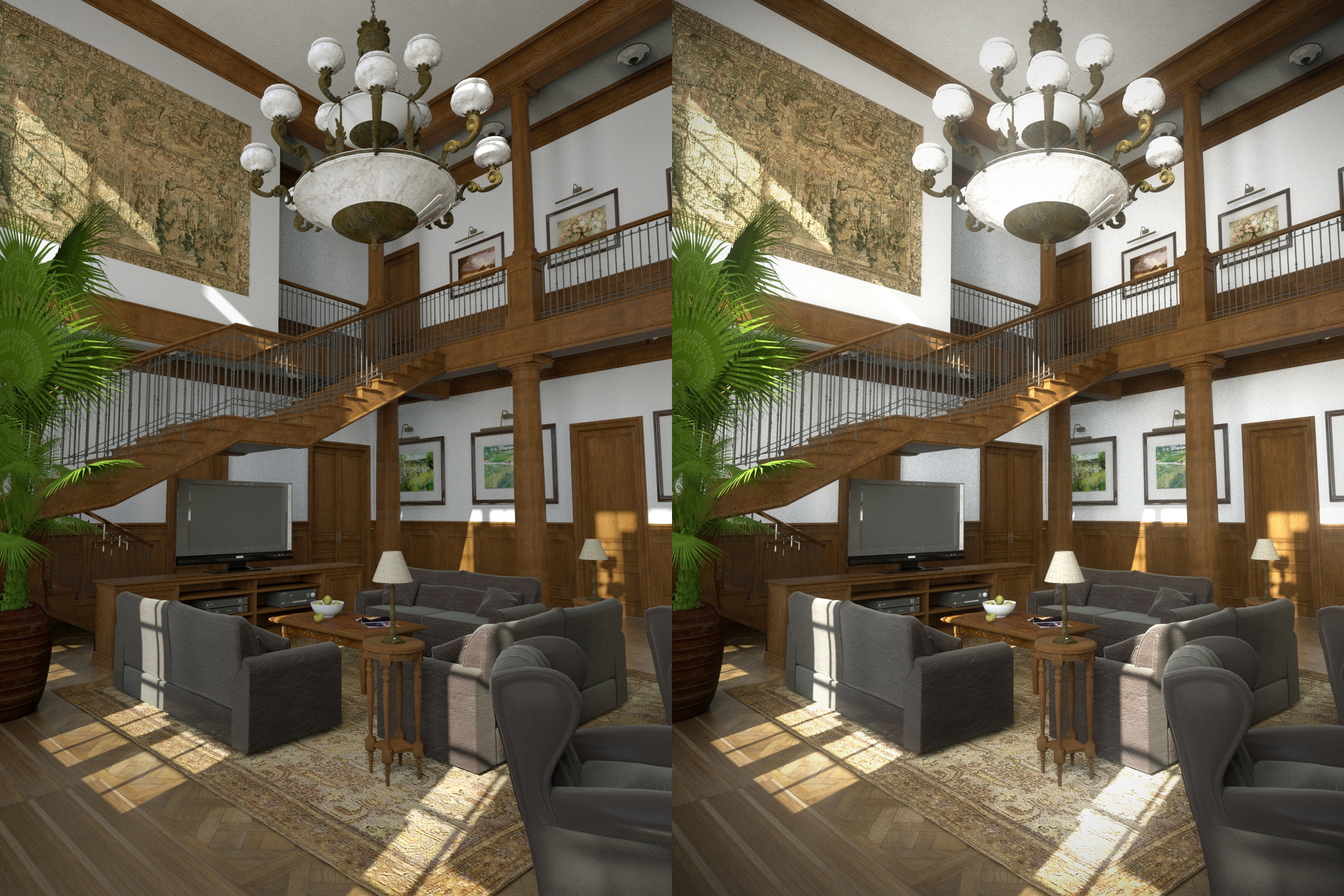

I´d like to share my workflow in AO mode renders. It´s pretty basic and obvious, but I´m sure someone will find it useful.
First of all, when you load your obj, you get this, in gamma 1.0:
In interiors is better to work in a 2.2 gamma space, so tweak it:
Then adjust the AO distance, to get the better shading you can:
It is always a good idea to have some daylight into the room, so add an environment:
To finish it, give it some love into photoshop, so you get the best enhancement of your render:
I hope you´ll find it useful. It´s a very basic procedure, but Ive found its a good way for fast interiors.

You must be aware that the bloom effect should be very well justified if you want it to look right. Personally I don´t use the octane bloom, since I´m used to fake it in photoshop. Could you post the render without bloom? I could post some screenshots to build a tutorial on faking bloom in photoshop the way I do.

Here is your scene with my bloom. Always try to be subtle.
