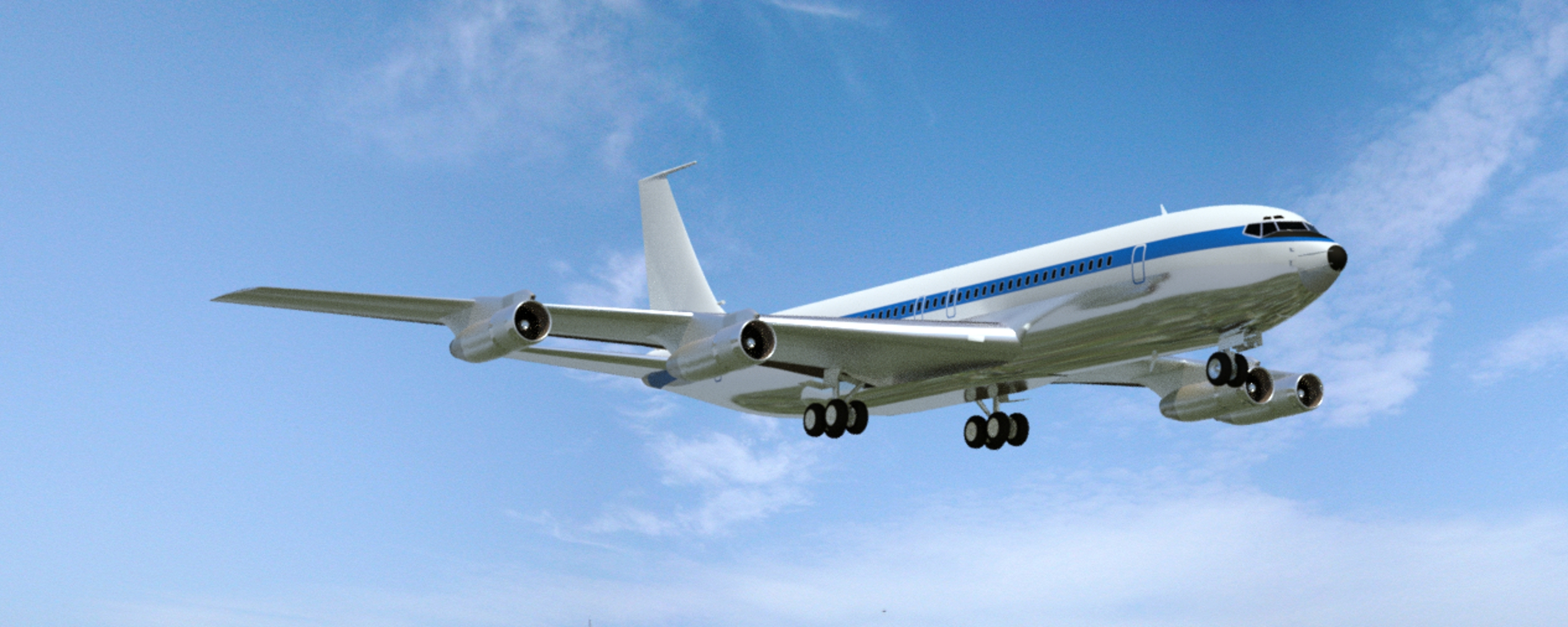

I hope I'm understanding what your asking... here goes...
First render with Alpha checked, using "Sunlight" setting:
Then render again with Alpha unchecked, use 'Texture Environment" and for your texture select the "Image" you want
Finally take the two resulting images and composite them in the graphics tool of your choosing: (for this I demo I just used Paint.net)
Hope this helped,
Steve
Hope this helped,
Steve

Thanks a ton, extremely help!ssouth wrote:I hope I'm understanding what your asking... here goes...
