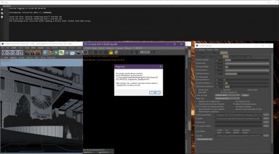

bepeg4d wrote:Hi Kalua,
are you having CUDA error 2?
Please, open the scene, then go to c4doctane Settings/Others tab, and, at the bottom of the panel, enable all the Log option checkboxes:
Then, load the scene in Live View, then in Picture Viewer, or until crash, and share the c4doctanelog.txt file that you find in c4doctane directory, or in the path specified in Settings/Others panel, thanks.
ciao Beppe

Posts: 10654
Hi Kalua,
I think you are having issues with Texture Caching.
Please open Standalone, go to menu File/Preferences/Application, and empty the Texture Cache, then disable the option.
Then go to c4doctane settings/Others panel, and disable the Use Texture Caching option.
Alternatively, you could navigate to `C:\Users\UserName\AppData\Local\OctaneRender\cache\texCache` and empty the folder.
ciao Beppe

Thank you, Beppe!!
That was it! It never hapened to me before! hats the benefit of cashing textures anyway? Speed up loading times?

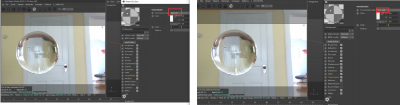

Is there anything wrong with my operation? Why turn on the same glass refraction as before?
