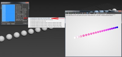

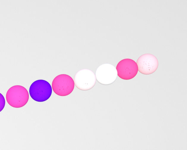

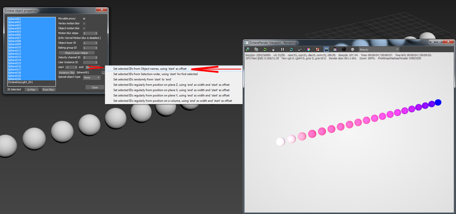

Hi guys,
new istance range node (3.07 SDK)
Regards
Paride

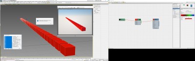

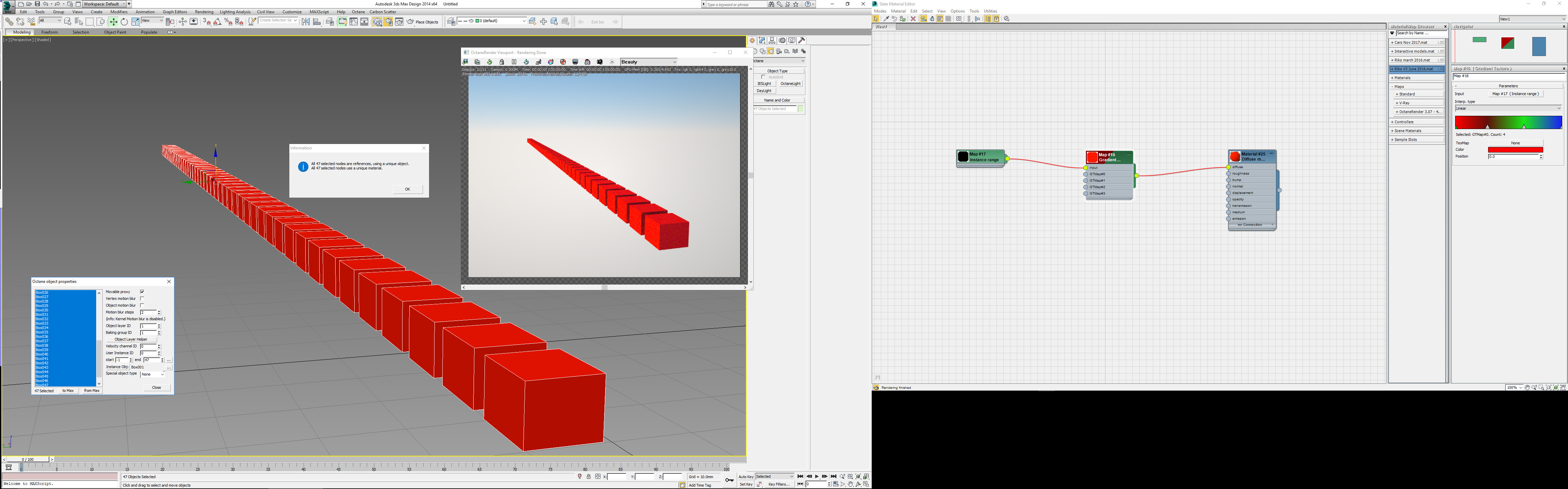

[OK well this is frustrating. What am I doing wrong Paride?
I have also set the max id to 47 as per your image.
attachment=0]instance range fail.jpg[/attachment]

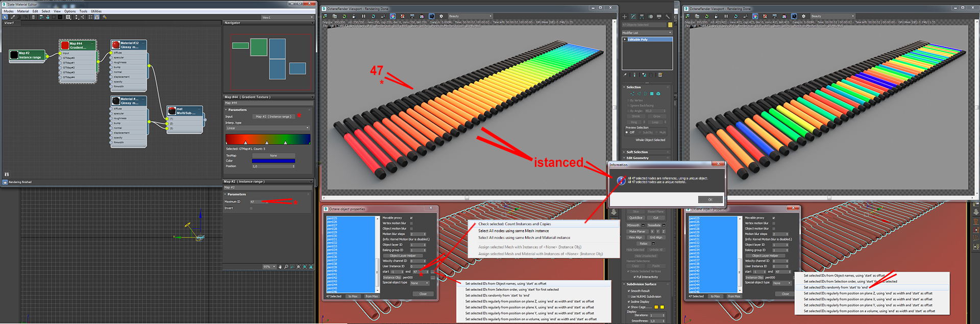

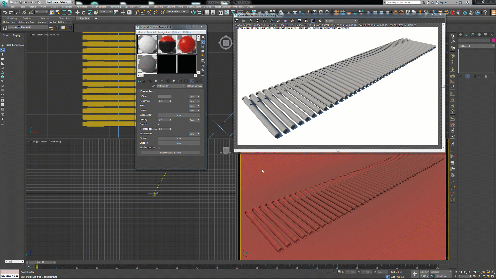

paride4331
Posts: 4001
Hi Rik,
meanwhile attach file test, I hope they help you.
Regards
Paride
01-random.zip
(749.04 KiB) Downloaded 618 times
02-gradient.zip
(748.98 KiB) Downloaded 671 times
paride4331
Posts: 4001
Hi HHbomb,
here for you,
Regards
Paride
OCT_pb_instrange.zip
(41.64 KiB) Downloaded 628 times
Rik
Posts: 423
Joined: Wed Jul 28, 2010 8:57 pm
Thanks.
Nothing was changing until I turned the octane proxy tick off then on again. Is this a feature?
Still don't know what's going on though.
What's maximum id in the instance map? What number does it represent?
What should the start and stop be in the oct obj properties? Is it related to the number of objects the material is applied to?
Buggered if I can see me getting instances of proxy trees with random colours on leaves and random variations across the different instances of those proxy trees.
paride4331
Posts: 4001
Hi Rik,
using 3dsMax array istance (animated GIF)
I apologize for the inconvenience; I think this issue depends on 4.43 version.
Try again using 4.44 which should have fixed it.
Regards
Paride
