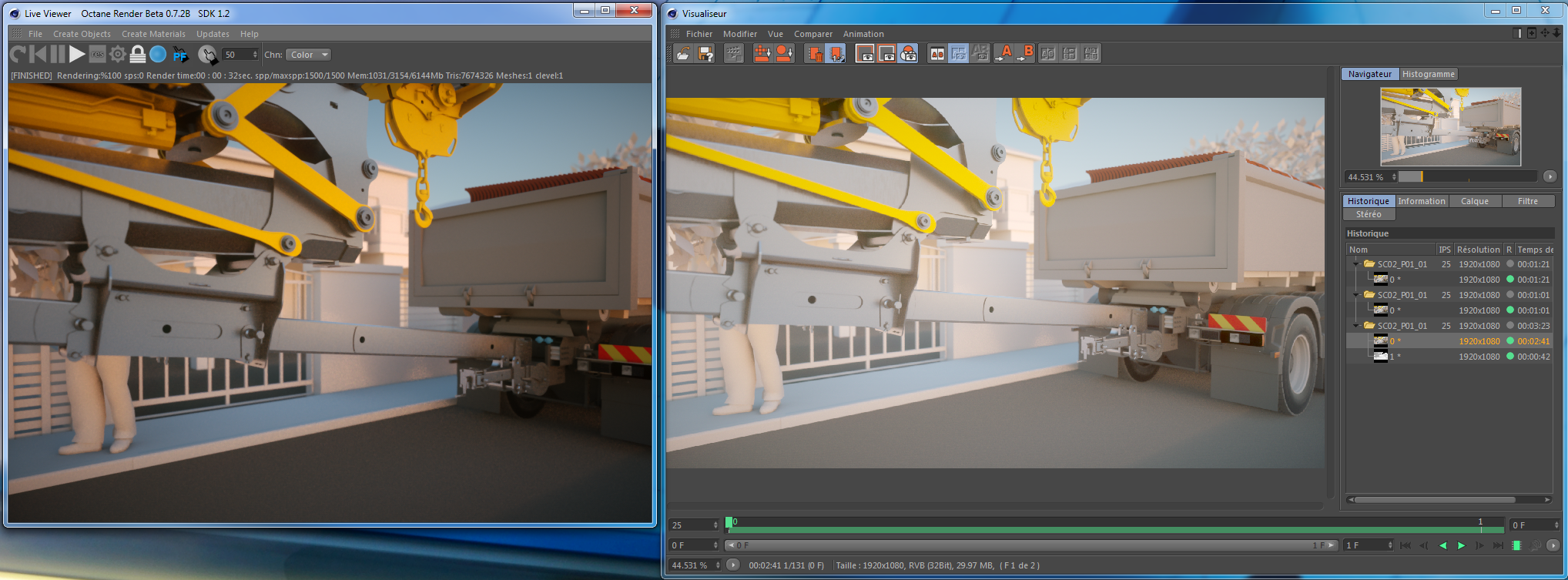

I've got a new problem, i'm sure that I'm missing something... but.. I need your help :)
Here's my problem : everything is ok while i'm working on my scene, in the live viewer. But when I'm launching the final render... the picture turns very bright, as you can see on the screenshot.
Any clue?

Well... I found a solution, but I'm still misunderstanding...
I changed my setting to pathtracing and everything was ok... then, i changed it back to Direct Light... and everything was still ok...
Am I running mad?

I think this is the linear workflow thing I had so much fun with... render in 16bit in the picture viewer or update scene/textures to full Linear workflow. search forum for 'linear workflow'
Also check you're cam tag/cam imager if enabled it will overwrite the global cam settings

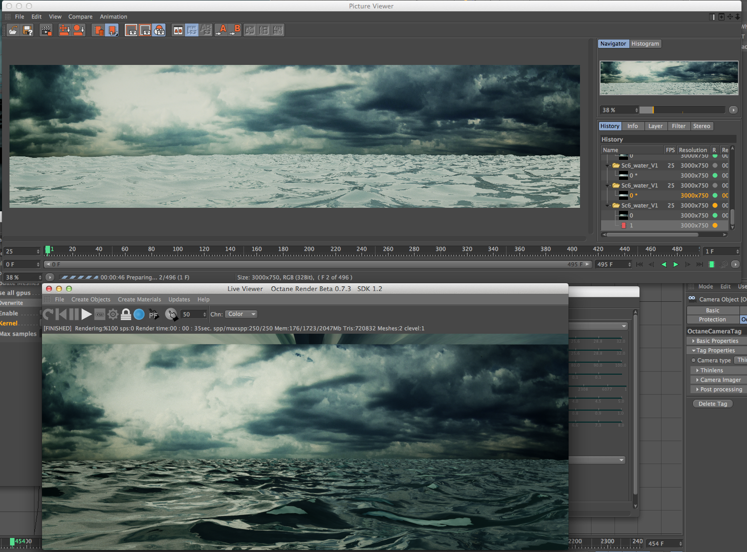

I am having the same problem.
I can't find anything about multipass in the manual. I also can't find the octane multipass setting in C4D.
Please help
here is the difference I am getting....
Posts: 16068
Location: Türkiye
http://render.otoy.com/manuals/Cinema4D/?page_id=109
there is a short info but enough i think. Your viewed images will be brighter but it must seem correctly when you open in a editing program.
