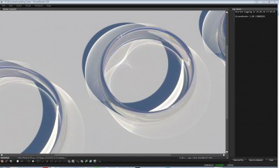

Hi.
Look my specs (signature) and Win 10 x64 with CPU@4.4GHz and GFX 364.96beta.
Primary videocard: Intel HD 4600 (i7-4790K) for monitor and second videocard: GTX 780 Ti Classified for GPGPU (CUDA or OpenCL).
Log after have rendered during 10 minutes at the speed of ~5.5 MS/s:
Code: Select all
Started logging on 24.05.16 10:39:40
OctaneRender 3.00 Demo (3000020)
CUDA error 719 on device 0: An exception occurred on the device while executing a kernel. The context cannot be used anymore and must be destroyed. All existing device memory allocations from this context are invalid and must be reconstructed.
    -> kernel execution failed (orderQueue)
device 0: PMC kernel failed
NOTE: I don't use any GPU and VRAM overclocked. :( But I'll leave my GPU to RMA in next month. ;)
