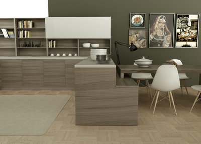

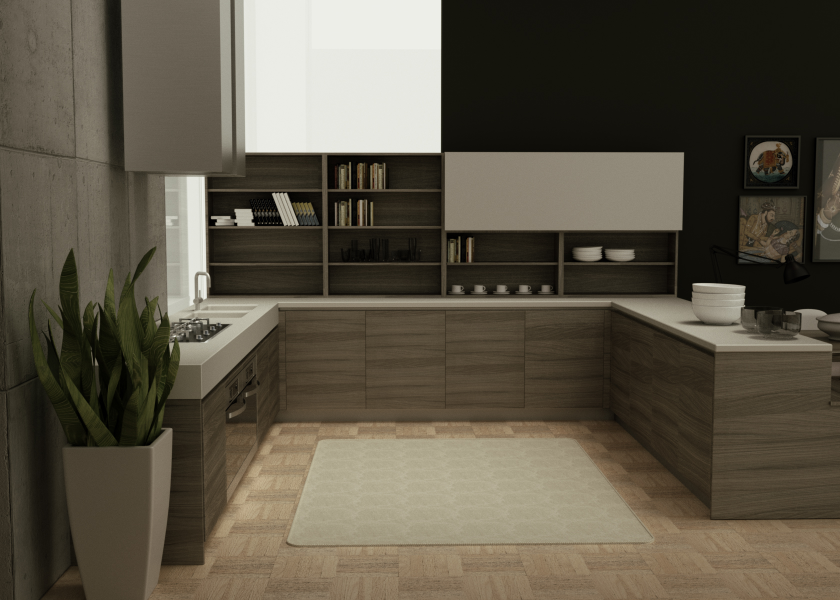

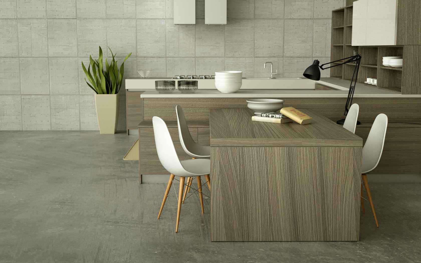

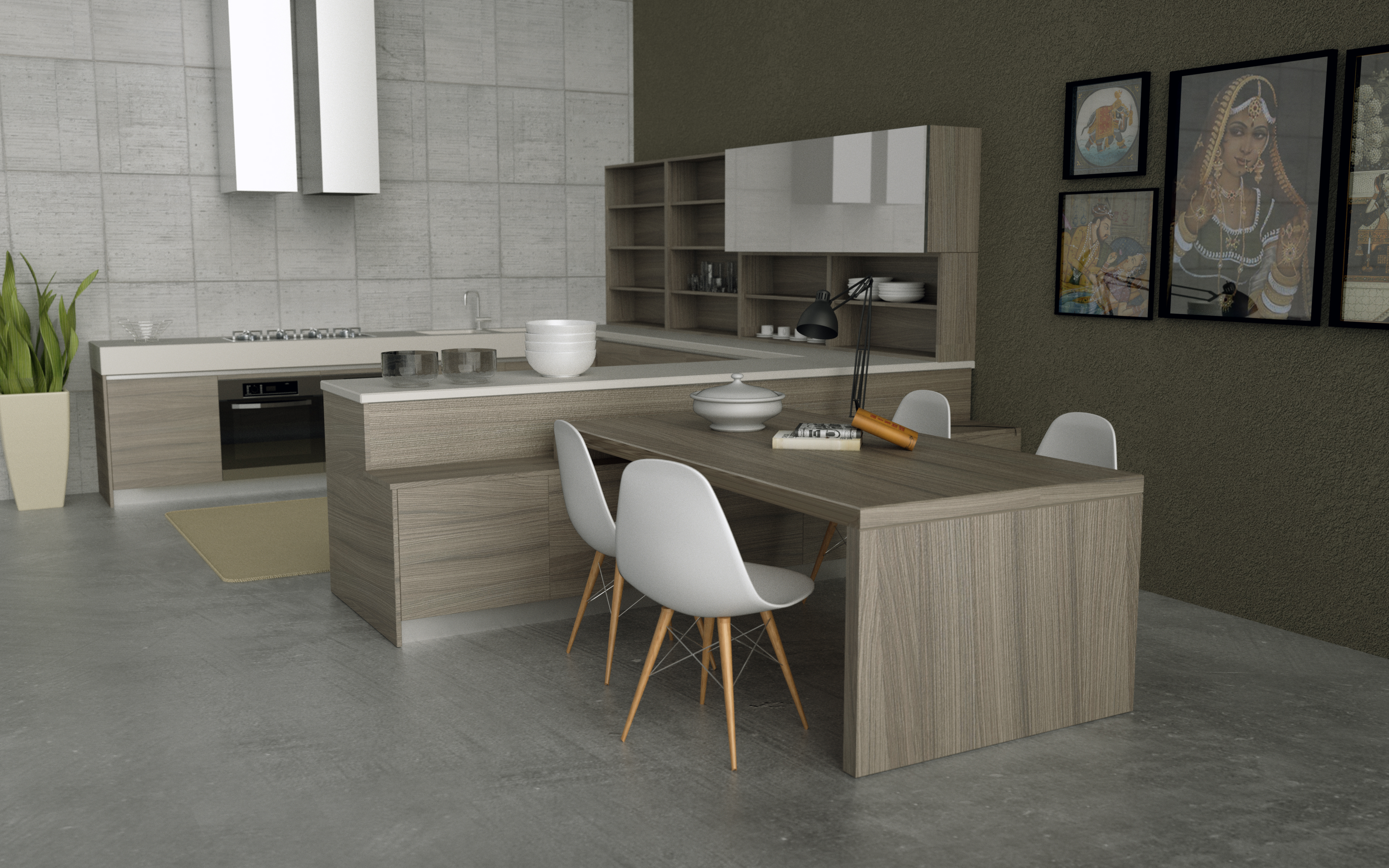

i notice that when i don't put a celling on my scene , the scene renders much faster and far more better, the final results are more accurate color wise.
THIS are few images , the 2 LAST are with celling and emitters lights and the 2 FIRST are with no celling and no emitter lights at all.
can i get the same results with some emitter light technique ??
THANKS
any way for lightinig my scene
Good work,
you could improve it by adding stronger light sources or daylight.
Now the lighting looks a bit flat like outdoor with coluds.
But the texturing and details are really nice.
Well done.
Well done.
Thanks, but I don't know if I made my point ?
Im trying to find a technique to light interior scenes more officiant .
It is obvious that the 2 first images are better in every terms, although I used the same materials.
I realized that when I don't use a calling, the environmental light, lights better the scene and much more faster, but that is not always possible ( no ceiling ) .
Can anyone suggest some way to make the same results (as the two first images) or just about the same ?
And yes I get allot of flat images , just if the photos where taken in a cold day and whith clouds, I tried to use images as backgrounds but I get strange results ( photos don't give enough light and if I increase the gamma I get a fade out image for background)
Please any suggestions
Thanks.

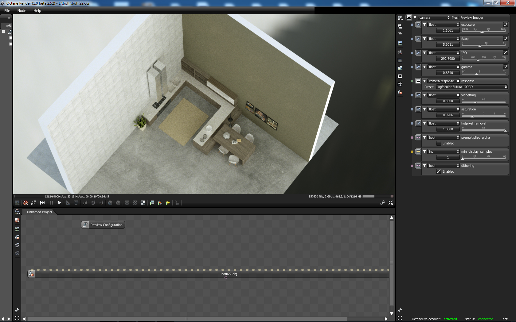

. How many windows do have to let environment light into scene.
That is a bit confusing. No cealling means open space above. No windows means closed wall.manos wrote:No windows , no cealling at all
I think you should zoom out to show about the environment and building openings/emitters.
Then we might help you better.
this is it.
by the way i'm not using nodes, is there a tutorial about them ?

I see. I think you should really go back and restore the surrounding. You should integrate windows or emitters.
You could try to use portals to speed up rendertime with the ceiling ontop. Or try to remove one wall only.
