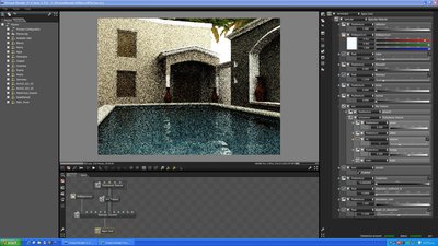

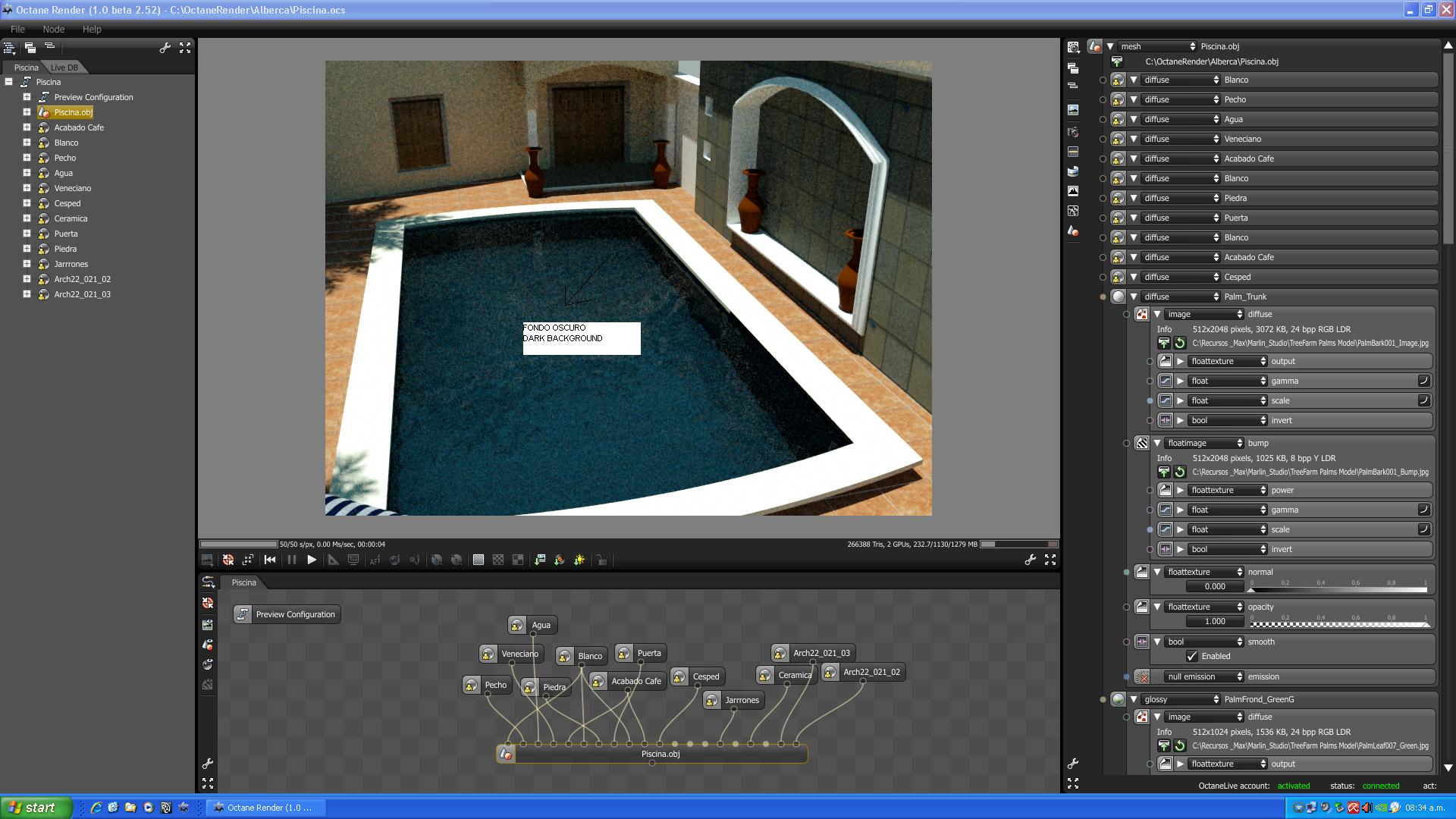

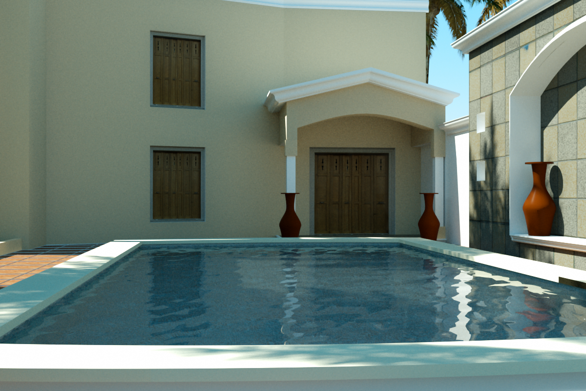

hello i would like know how i can create a natural white water clear becouse mine is so dark i been used material livebd and is the same result
i add image, thank you for your read this profile
dark water

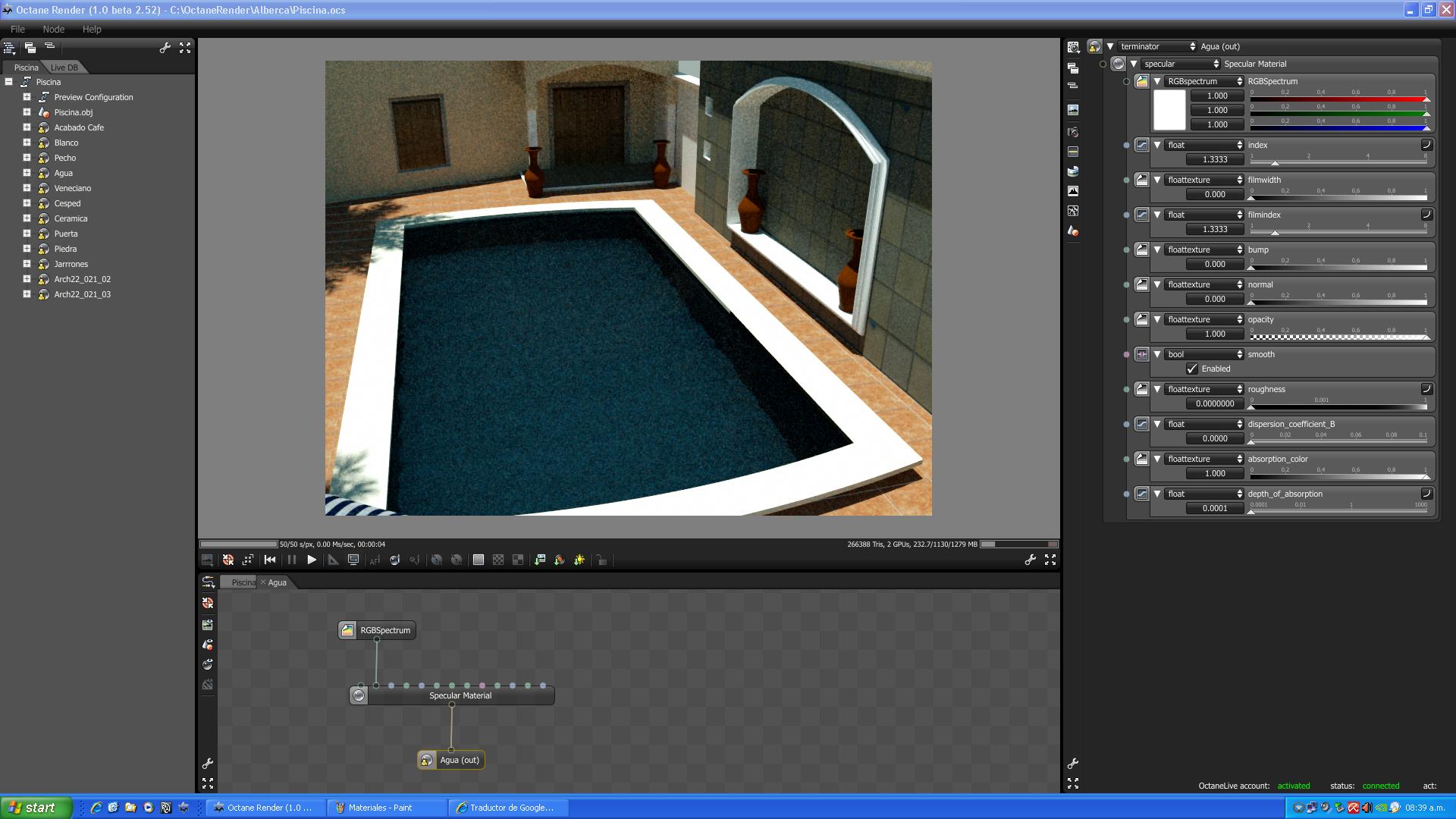

use the little trick of adding some opacity to the specular material of the water, for a bonus, use a texture mix in the opacity with a noise generator and put something like 0,9 and 0,6 in the values, play with the scale of the noise and you'll get fake caustics on the go....
Also, your absorption is like 0.0001, which means that most of the light is absorbed after it has passed through 0.0001m of water, more accurately: 0.1mm of water, try increasing it

gracias kubo por tu comentario pero donde encuentro este ¿ noise generator ?
thank you sportler i will the change and i`ll upload image

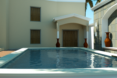

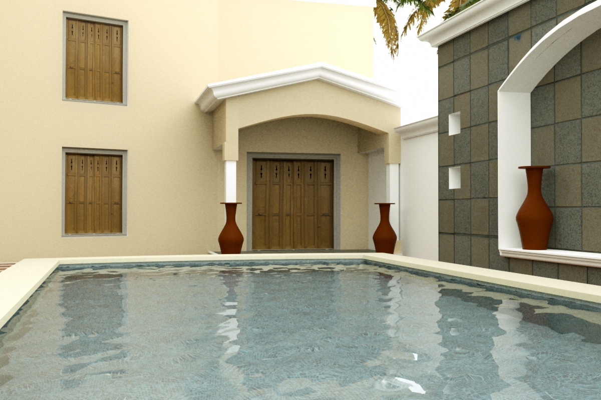

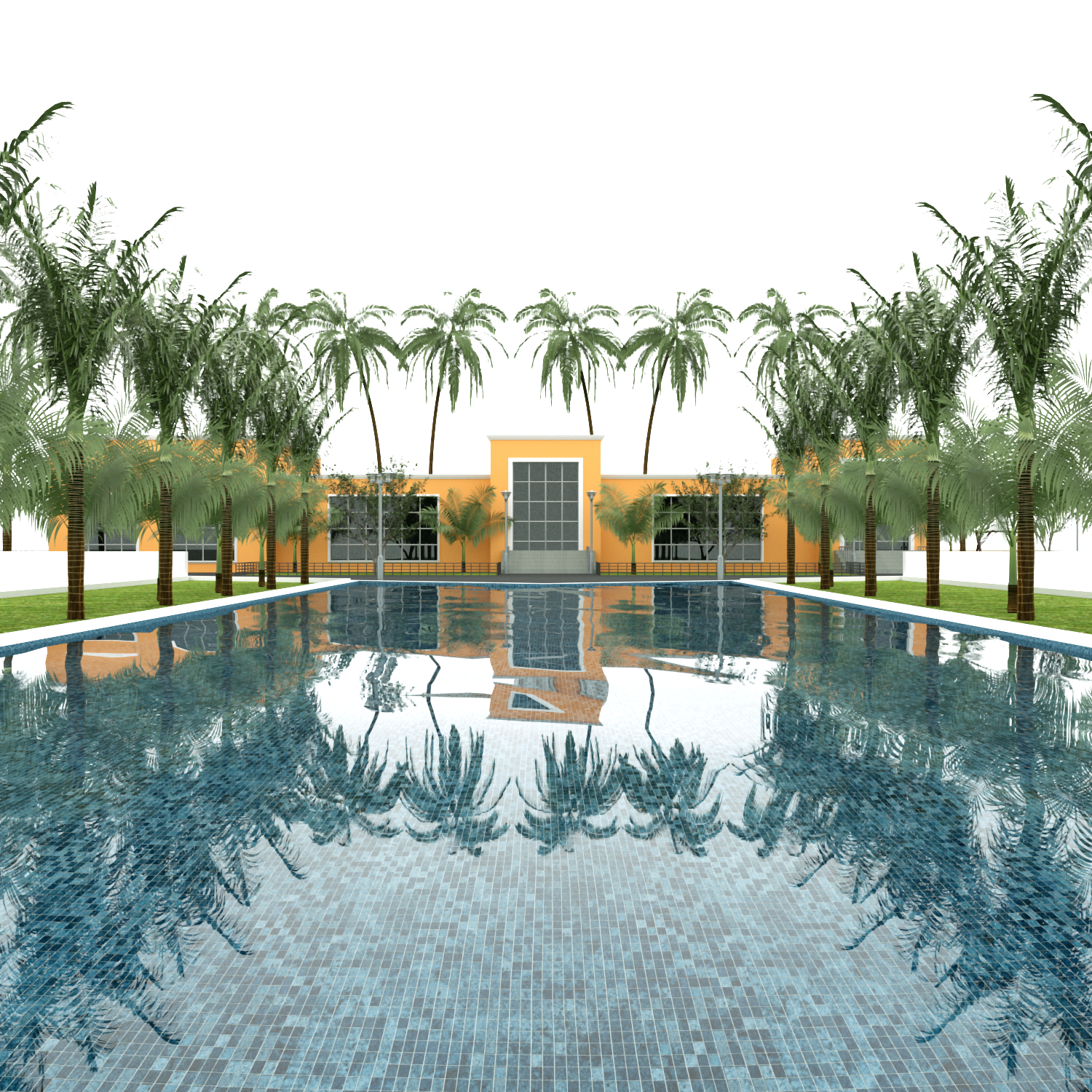

in the image of palms and water mirror i did this texture with the version 2.46 and i don't had problem just was an specular with the values 1.333 and nothing more i don't know why i can't do the same texture with 2.52 version
you were using an HDRI to light the scene in the first one, on the second one you are using the sun.

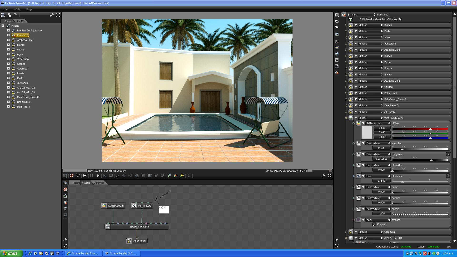

The noise, use a turbulence node attach it to the first slot on a mix texture node, and play with the other 2 values till it looks correct.

hi kubo is not an hdri is just the background white of the octanerender, none texture
i'll try using your comment

well, doesn't matter if it's an HDRI or a white texture, same applies. The sun right now has a different aproach and as long as you don't do the opacity trick with it light won't go thru your objects.

thank you again kubo, you are so friendly i'll upload image to see the caustics in the water, how do you know much about this program ?

The Sun is very blue, but without the blue sun water in not blue
