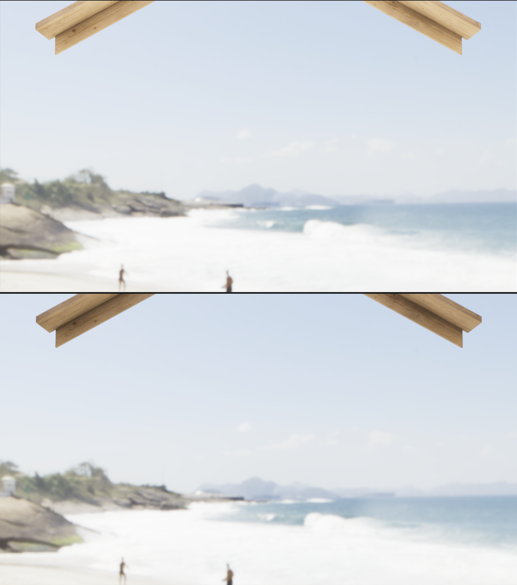

I finally updated to Octane 31.7, but opening scenes made in Octane 30.11 + Blender 4.5 in Octane 31.7 + Blender 5.1.1 completely breaks them.
A few issues:
Materials using height maps become invisible.
If using Vertex Displacement, I have to disconnect the node.
If using Texture Displacement, I have to switch from “High” to “Normal” mode (which strangely gets set automatically).
Area light visibility/reflections are broken.
I have Octane Area Lights set to be invisible in reflections on certain objects, but in 31.7 the lights are reflected anyway no matter what I do.
Biggest issue: lighting looks completely different.
HDRI seems mostly fine, but Area Lights are MUCH darker. In some places I need to increase power 10x to get something remotely similar.
I’m attaching a screenshot comparison:
top = Octane 30.11, bottom = Octane 31.7.
Nothing was changed — it’s literally the same file opened in different versions.
The object in the screenshot is lit by the HDRI plus a front Area Light.
So basically: what is happening here?
Are these known issues between 30 and 31?
How should I even approach troubleshooting this?
Right now this scene is basically unusable in 31.7, and I want to understand what changed before starting new projects there.

31.7 integrates Octane 2026.3, so scenes created with older Octane versions, such as 2025.5 / 30.11, may show different results or require some adjustments.
The way RGB Image Color Space and Gamma work have chnaged, for example.
In general, my advice is to keep the older version installed when working on important projects created with that specific version, especially if you may need to reopen or continue them later.
That said, it would be very helpful if you could share a scene that reproduces the issues you listed. This would allow us to take a closer look and check whether these are expected differences between versions or actual issues that need to be addressed.

The most important change is about the Color Space option in the RGB Image nodes. It should be set to Linear sRGB + Legacy Gamma to work properly.
By default is set to sRGB and probably that also happens when loading "old" projects.
I rember we "fixed" that already, but maybe we had some unwanted regression.
For now, please just check the option in your scenes. I remember I made a script able to change the Color Space to Linear sRGB + Legacy Gamma for all the Image Nodes in the current scene and I can provide it if needed.
