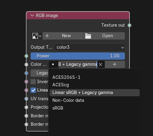

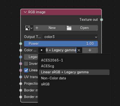

The most important change is about the Color Space option in the RGB Image nodes. It should be set to Linear sRGB + Legacy Gamma to work properly.
By default is set to sRGB and probably that also happens when loading "old" projects.
I rember we "fixed" that already, but maybe we had some unwanted regression.
For now, please just check the option in your scenes. I remember I made a script able to change the Color Space to Linear sRGB + Legacy Gamma for all the Image Nodes in the current scene and I can provide it if needed.
I hope this helps.

I've attached the addon.
You should find it in the Octane menu in the 3D View.
Just click on Fix All RGB Image Nodes after loading your scene.
I hope it helps.
I hope it helps.
