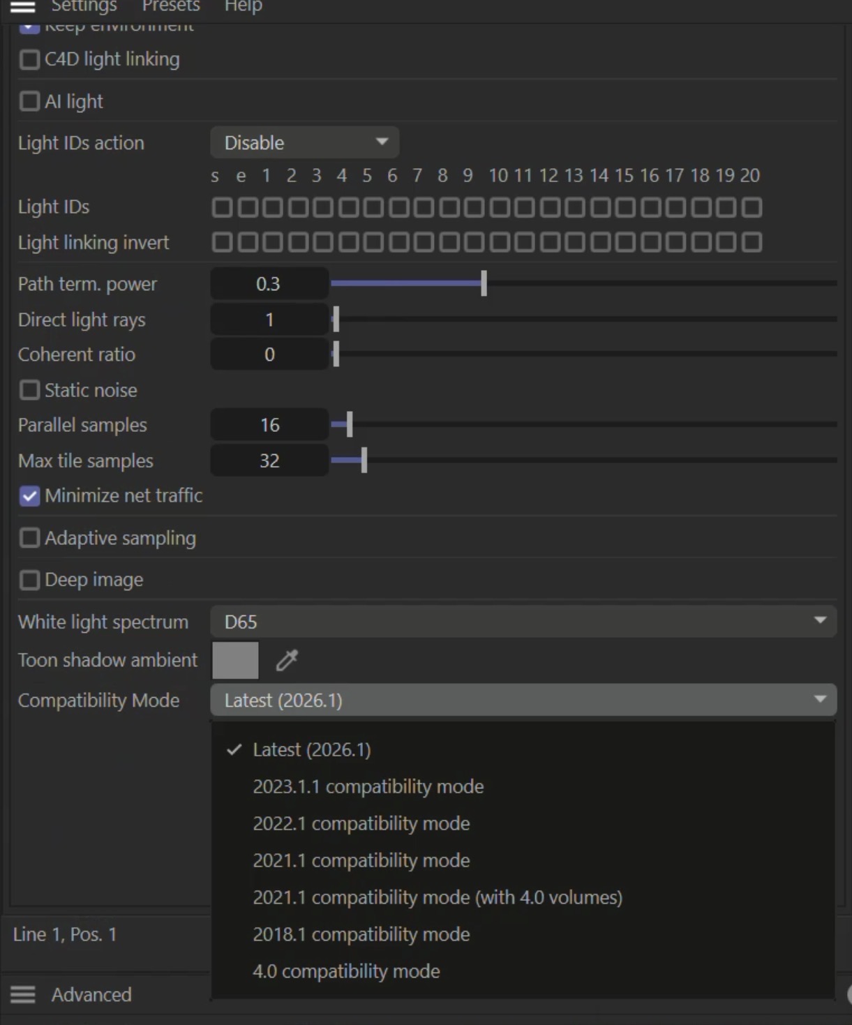

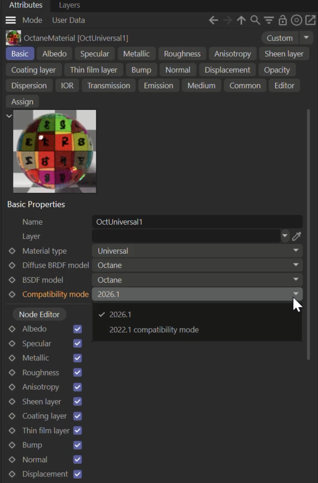

In general, if you are having issues with previous scenes, please note that you can also select all the materials, and in the Basic tab you can change the compatibility mode to a previous version:
And you can do the same also in Kernel settings:
ciao,

Unfortunately, the solution to change compatibility mode does not resolve the issue with the Image Texture color space or the Transmission mode for me, and also when using for instance an Octane Layered Material, one has to deep dive in the node editor to change the compatibility mode, so selecting all and switching is no longer a quick operation.
