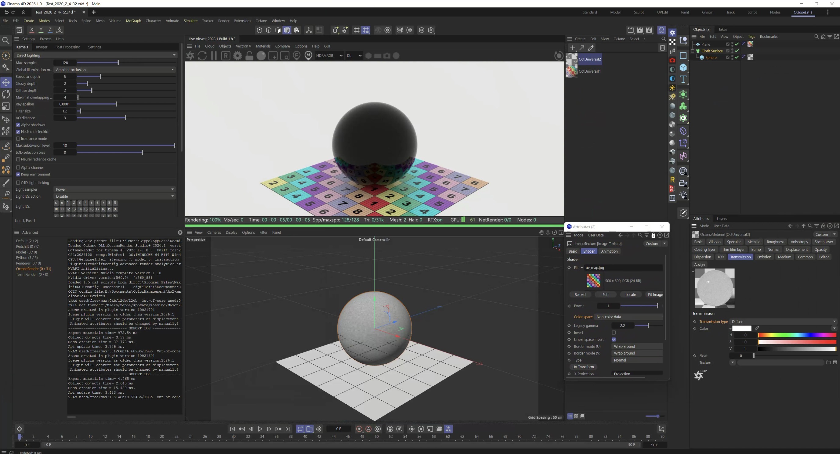

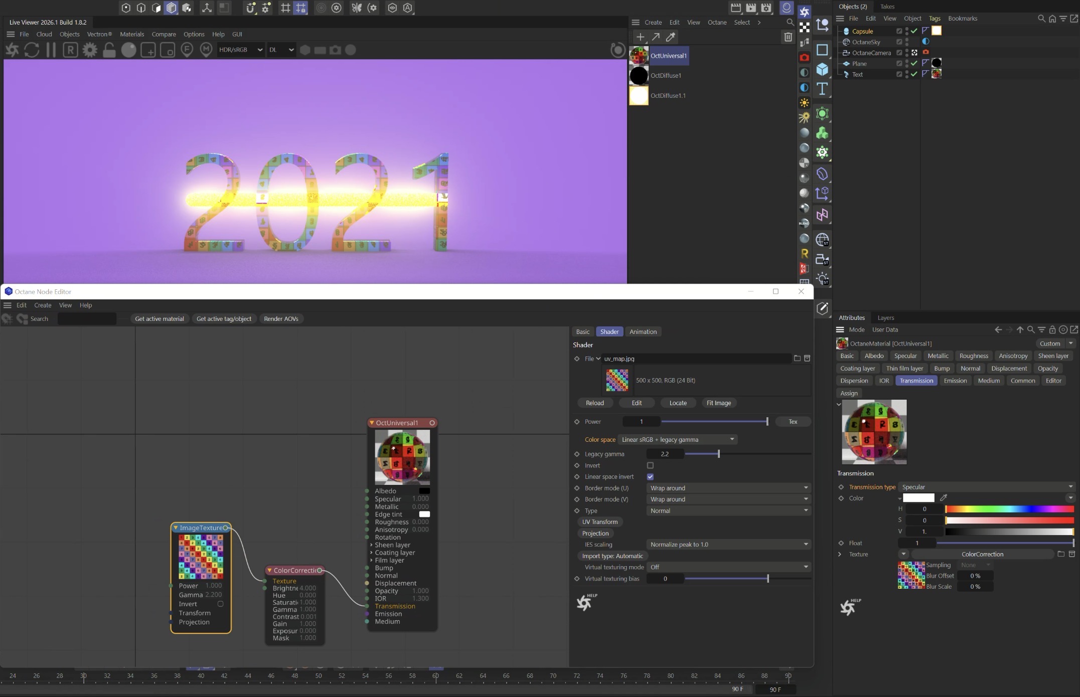

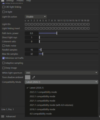

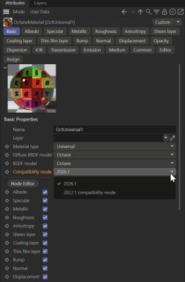

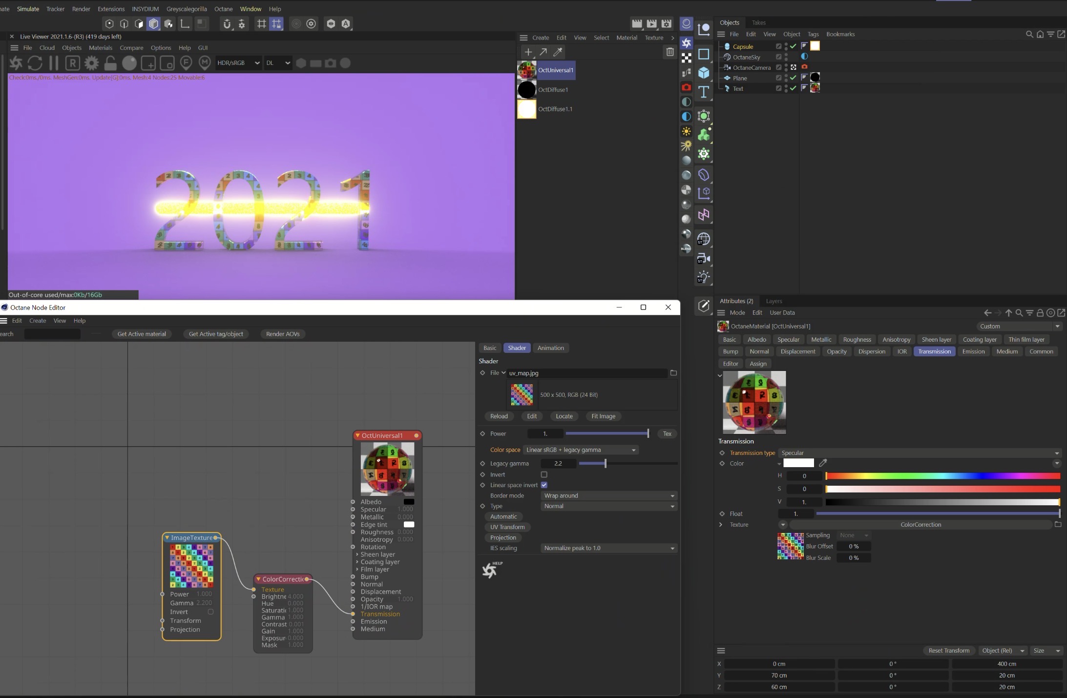

I have just tried to create a scene with c4doctane 2021.1.6-R3 in C4D R26, with ImageTexture node and an Universal material with Transmission type set to Specular: Then opened with C4D 2026 and OctaneRender plugin 2026.1-v1.8.2, and both color space and transmission type are correct: In general, if you are having issues with previous scenes, please note that you can also select all the materials, and in the Basic tab you can change the compatibility mode to a previous version: And you can do the same also in Kernel settings: ciao,

Unfortunately, the solution to change compatibility mode does not resolve the issue with the Image Texture color space or the Transmission mode for me, and also when using for instance an Octane Layered Material, one has to deep dive in the node editor to change the compatibility mode, so selecting all and switching is no longer a quick operation.

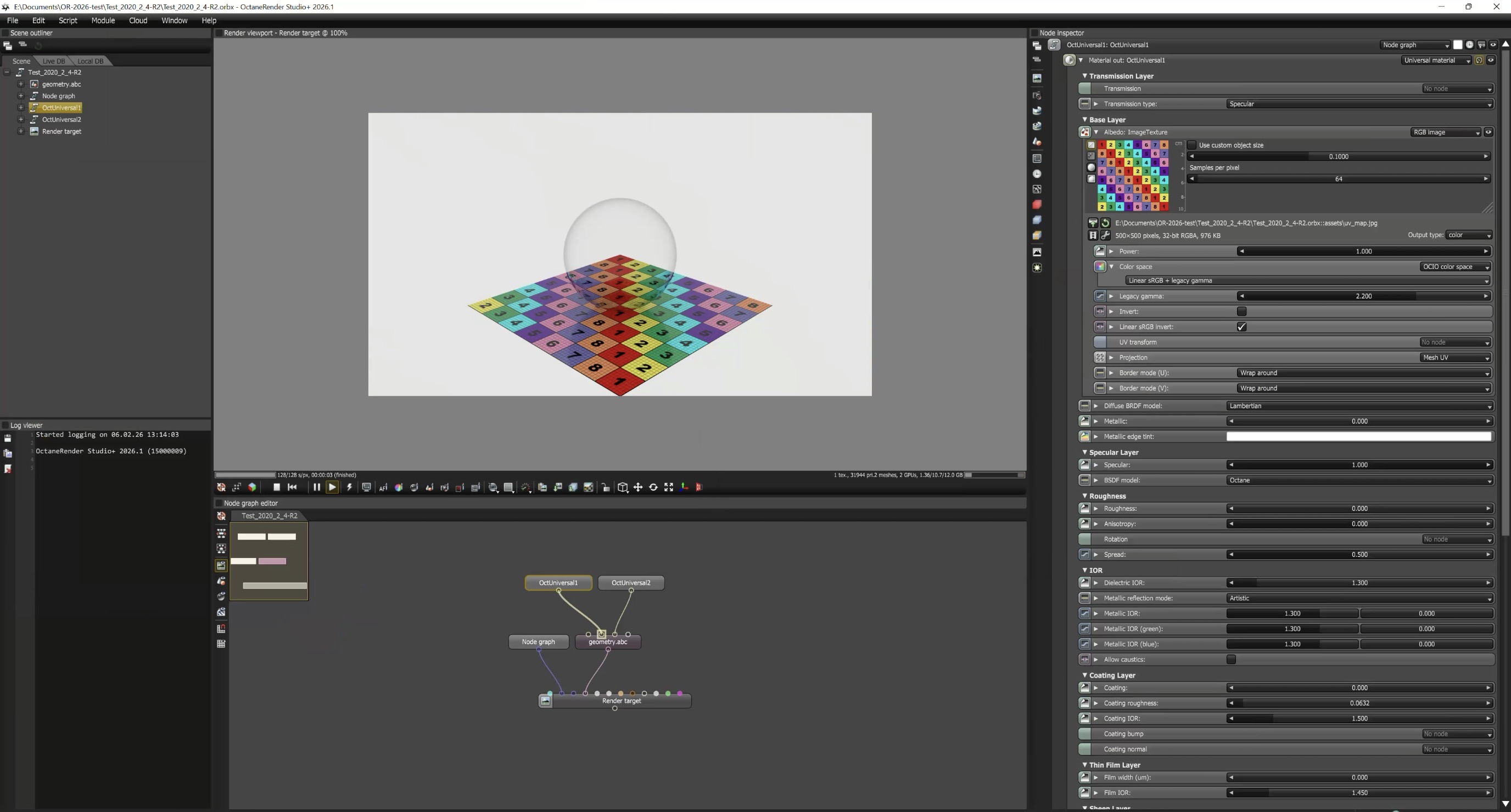

It turned out that the scene was made with a more older c4doctane version, 2020.2.4 to be precise: The "Non-color data" issue in ImageTexture node is a 2020.2.4 thing, already fixed in c4doctane 2020.2.5, while the Transmission issue is also present in 2020.2.5 version.
I have created a more simple scene to reproduce the issue, and I can confirm that it doesn't work in 2026.1 plugin version: Anyway, it is definitely a plugin issue, because I have exported the scene in .orbx from 2020.2.4-R2, and Standalone 2026.1 can open it correctly: I'll share the scene with plugin devs for a fix, thanks again for your collaboration.
