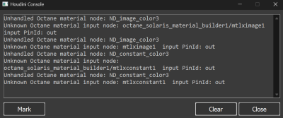

None of the MaterialX nodes work with Octane materials.

Thank again Galleon,
We have been looking into this issue.
Will get it working for the next release.

Hi Galleon,
It seems we support the USD MaterialX builder straight away!!
Could you please give it a go and let us know while we're investigating?

I tested that and it works fine. They just don't work with Octane materials

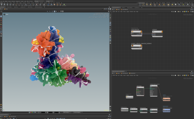

Can you also investigate how to use displacement with MaterialX builder?
This is the way to do it in Karma. That doesn't work with Octane and i don't see another way to do it.

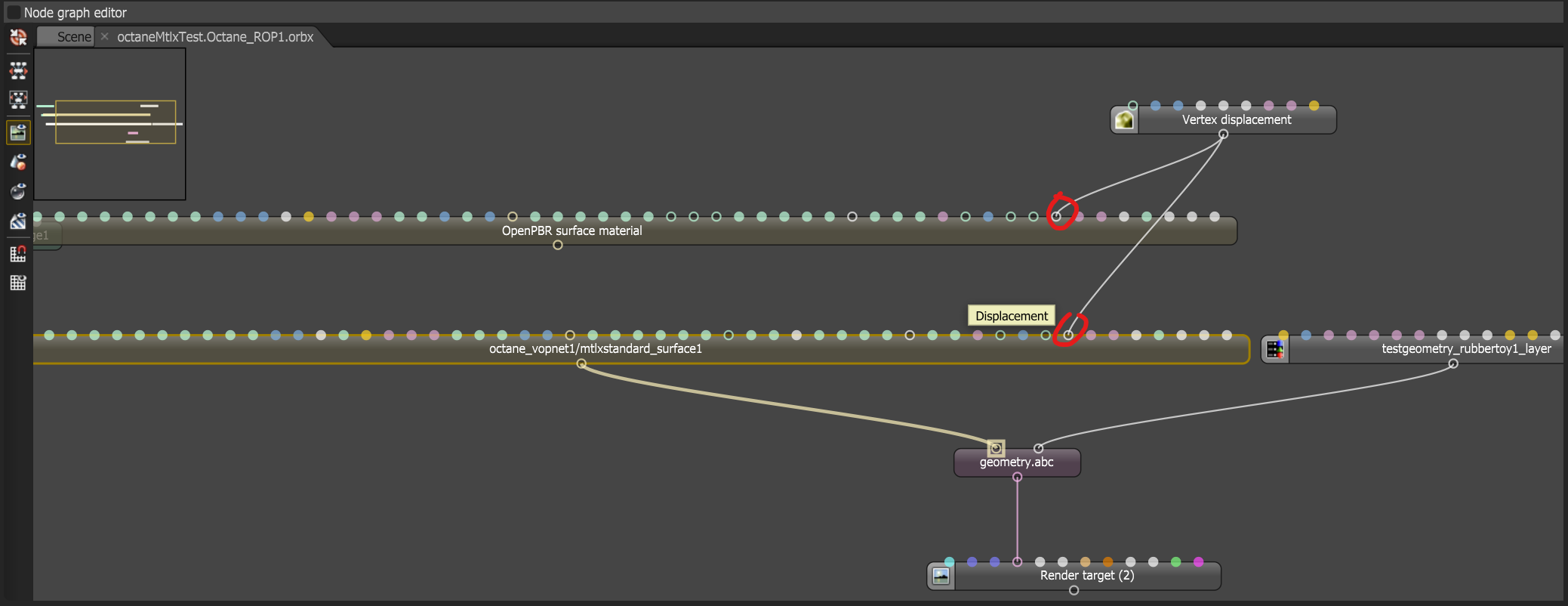

It seems that MtlX Standard Surface/OpenPBR Surface have a pin for displacement in Standalone but that is not the case in Houdini.
This is not an issue only in Solaris but also in the main plugin.

Hi Galleon,
Thank you so much for sharing the Karma workflow.
We will check with our developer if we can keep the same workflow.
