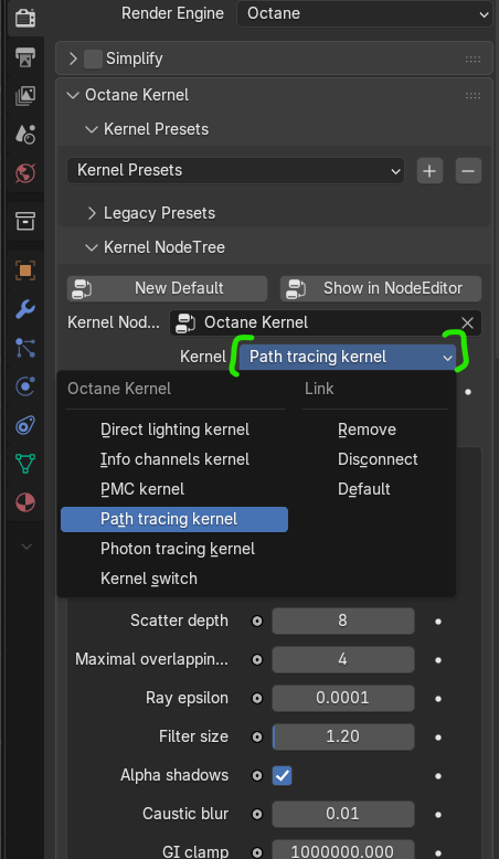

Also, if you need to change Kernel type, just do it from the Render Properties:
