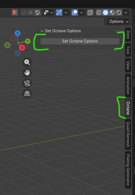

Those option should only be used at the start of a session.
If you need to setup Octane's general basic options, please use this addon:
viewtopic.php?t=83942
Once installed, you'll find a new option in the 3D view:
This is not "destructive", and pretty useful if you're starting from a Cycles scene.

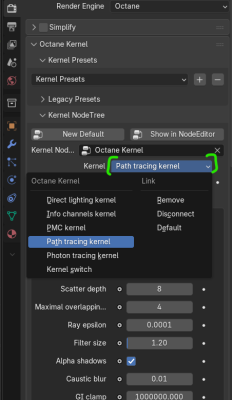

Also, if you need to change Kernel type, just do it from the Render Properties:
