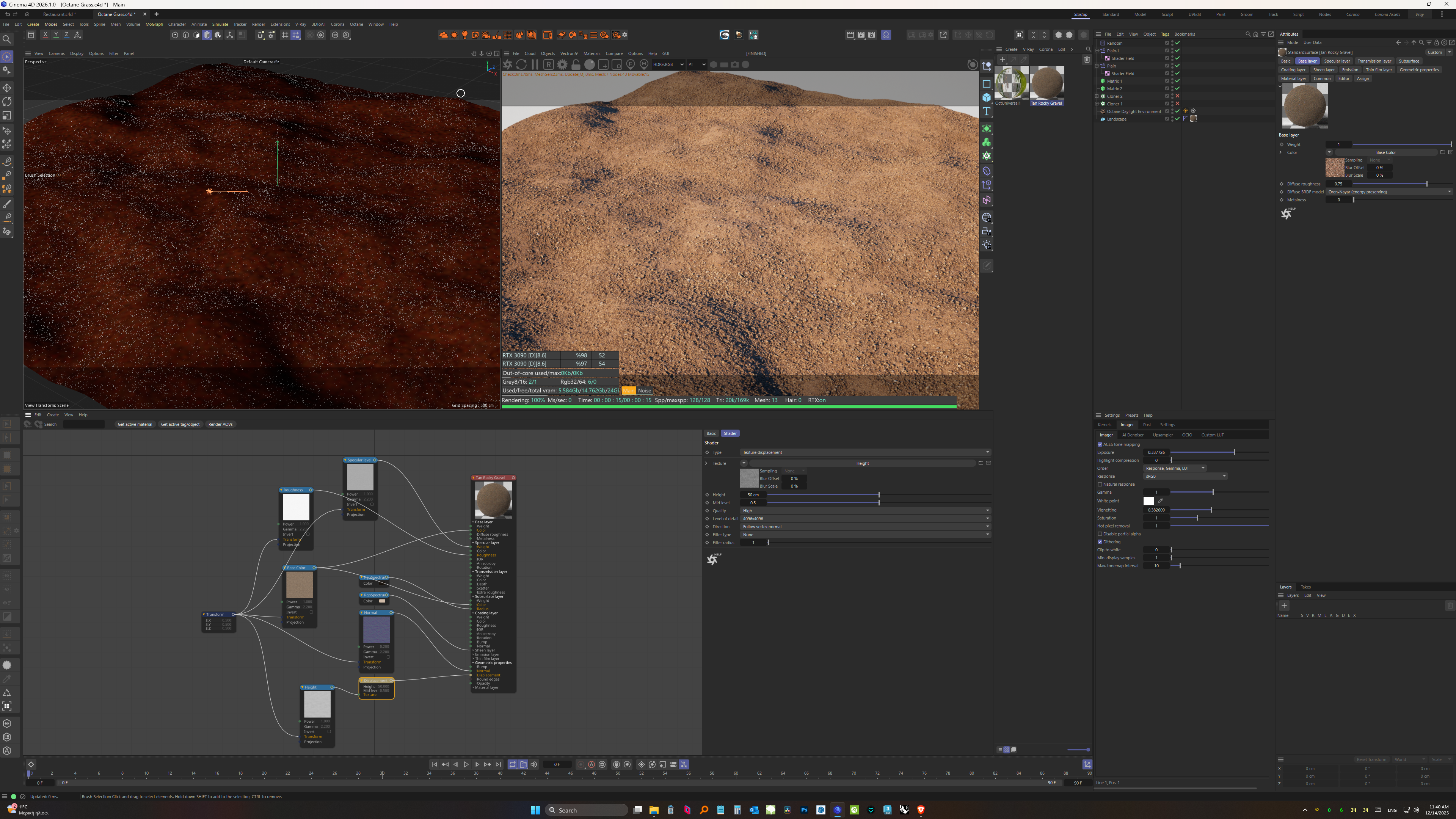

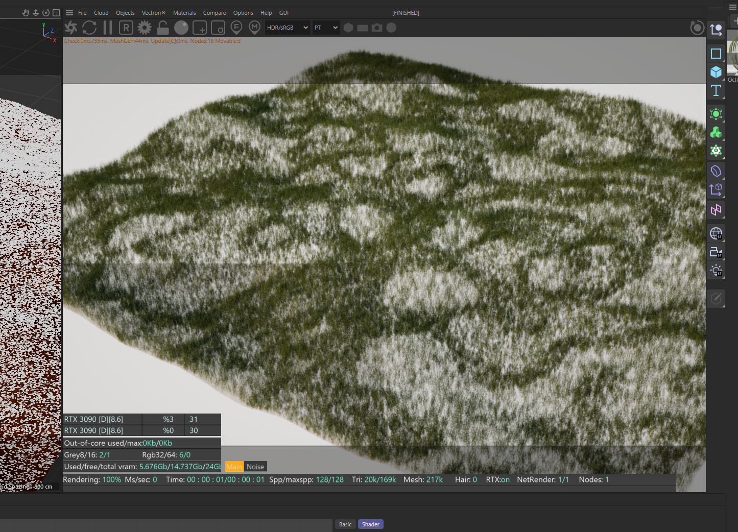

I think I found a bug on the latest version of Octane. If I render using my second PC and enable the network rendering, the displacement is not working, rendering white. If I render locally it renders fine and if I disable the displacement it renders fine on the network as well. So I know it's not missing textures etc.

It is a known issue of new High Quality mode of texture Displacement, and core devs should fix this for next 2026.2 SDK.
In the meantime, you need to set the Quality mode to Normal, or use Vertex Displacement type.
