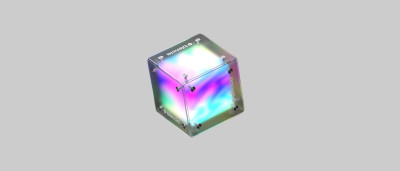

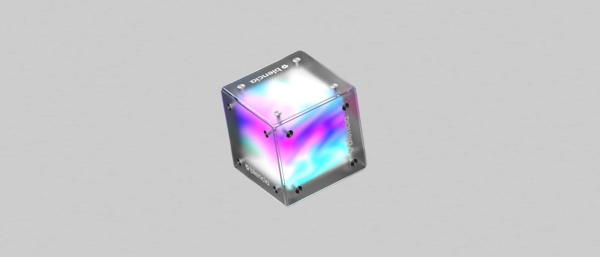

Hello ! I'm trying to find a way to control the colors of the "PaintColors" OSL shader, but so far everything i tried didnt work out.
What i'm trying to do is to remove some of the colors, only to keep blue/pink hues; is that possible or do i have to find a workaround in post ?
So far I tried to remove the colors I dont want by driving the OSL shader into an octane gradient, but it doesnt give any good result as it usually make the gradient less "smooth"
Thanks in advance !

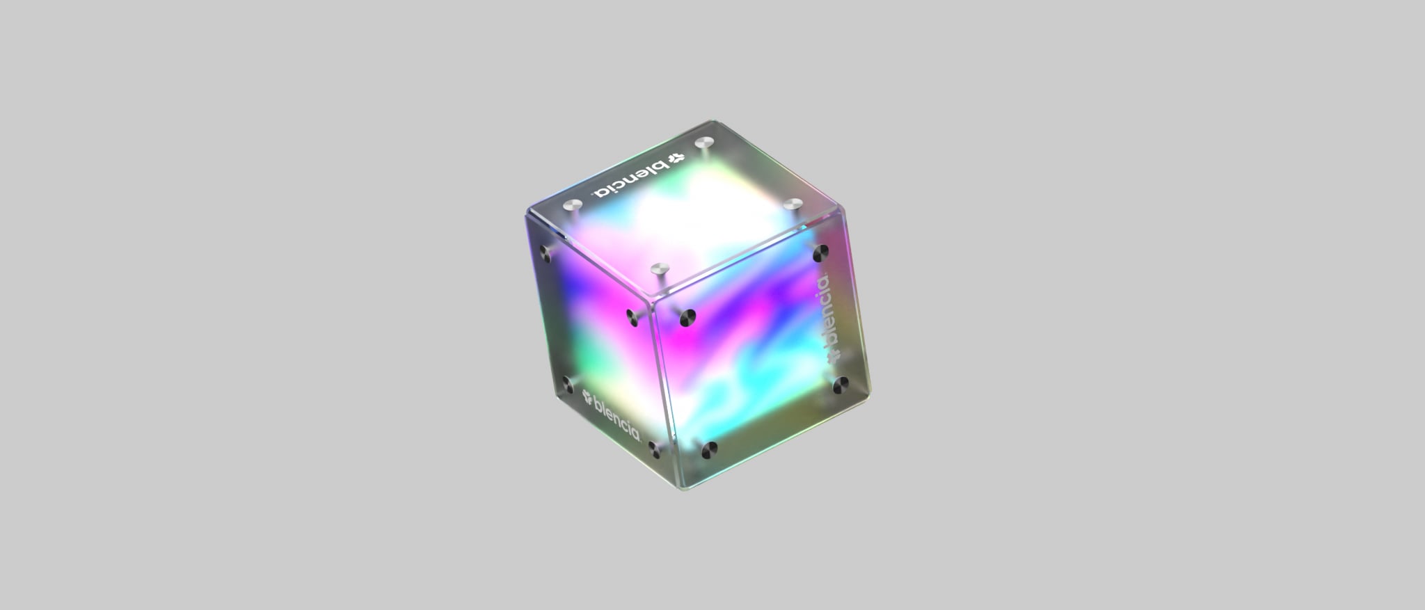

Posts: 10612
A solution can be to multiply or divide each single RGB component in the final c vector color.
In the following example, I have multiplied the Red and Blue components by 4, and divided the Green component by 100:

    c=vector((clrInt*sin(3.0*p[0])+clrInt)*4, (clrInt*sin(3.0*p[1])+clrInt)/10, (clrInt*sin(p[0]+p[2])+clrInt)*4);

Hi ! Thanks for your reply.
This is going in the right direction definitely, but i'm realizing that since white is the combination of the 3 primary colors, it won't work that way...
Maybe I should just look for another OSL shader to realize that effect, or just do it in post by removing green and yellow hues directly there
