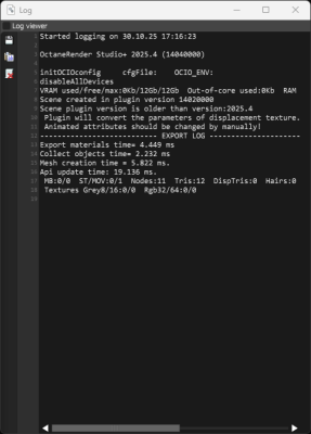

I have an issue where whenever I start the IPR for the first time at least one log window opens up, sometimes 3 to 4 (log attached). I then need to resend my scene to the IPR in order to get it working. If I forget to start the IPR before trying to render to picture viewer the whole program will also sometimes crash.
Can someone please explain why this happens and how to avoid it?
Thank you!

Posts: 10531
From which previous version the scene was built?
Have you tried to merge/copy-paste the scene into a new empty one, and rebuild both Kernel and Render Settings from scratch?

I think this may be what the issue was! Did a quick test and it seems to have fixed it. I will report back if it happens again, thank you.
