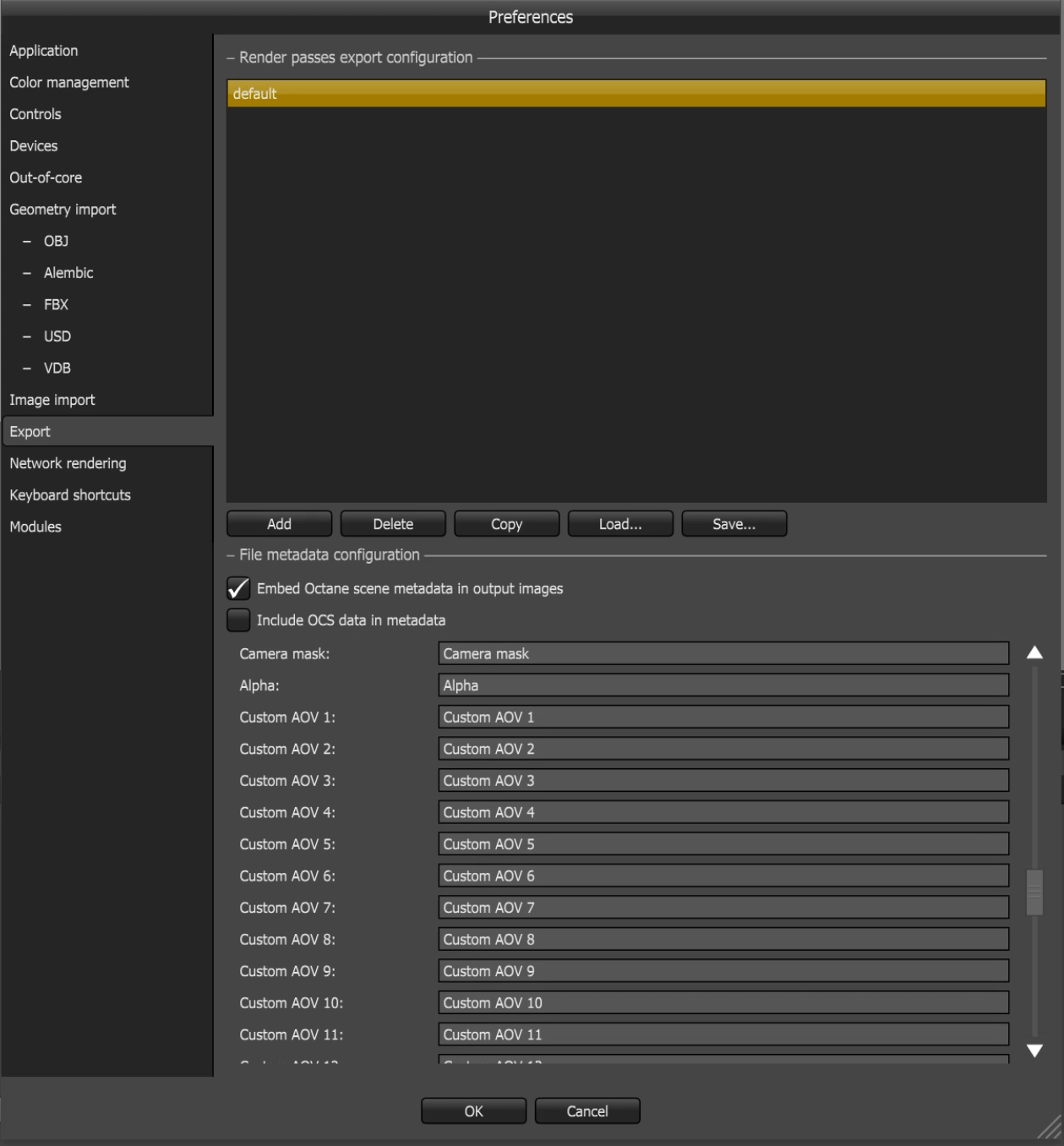

Hi Peter,
Sorry, I don't think this is currently possible, you can edit any AOV name in Preferences/Export, but not for Output AOVs: ciao,
Beppe
Beppe
