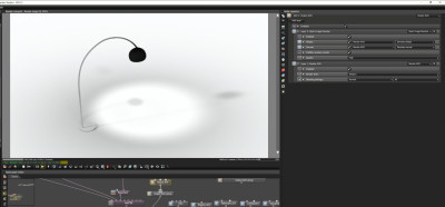

Gidday Geppe
I am afraid this is a bit beyond me
I am not sure of the difference between AOVs and Render layers
I am unable to add the denpoise tone mapping to a shadow render layer
Not asking you to solve it of course... but any ideas on where to see it explained in example fashion.
The new features node does not show me how to "hook" it all up.
I attached an orbx in case its a simple lickity split thing to do.
Thanks mate as always
Peter

Posts: 10384
Hi Peter,
You just need to create a new Output AOV with two layers.
On first layer, the Render AOV/Shadow pass.
On the second layer, the Open Image denoiser node connected to both Denoised Albedo and Denoised Normal passes:
Peter_AOV_Orbx_b.zip
(420.42 KiB) Downloaded 6 times

Ah ha
This is awesome thanks
I notice the output AOVs are just labelled Out1 Out2 etc
Is there anyway to give them a better name? That in some way refers to the thing they are denoising.
ie the shadow render layer is called Shdw and the outAOV is called out1
Thanks mate
