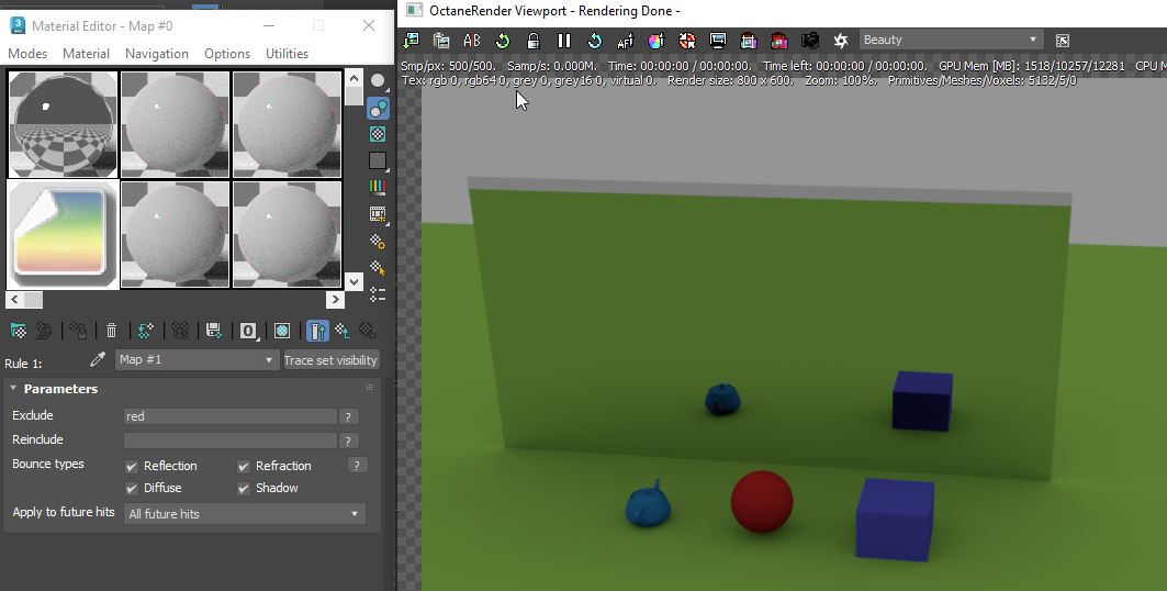

TraceSet_Sample1_Reflection.max
You can see how the red sphere is excluded from reflections in the mirror while the rest of objects are still displayed.
Sphere001 has an Octane Geometry modifier with Trace Sets set to the keyword 'red'

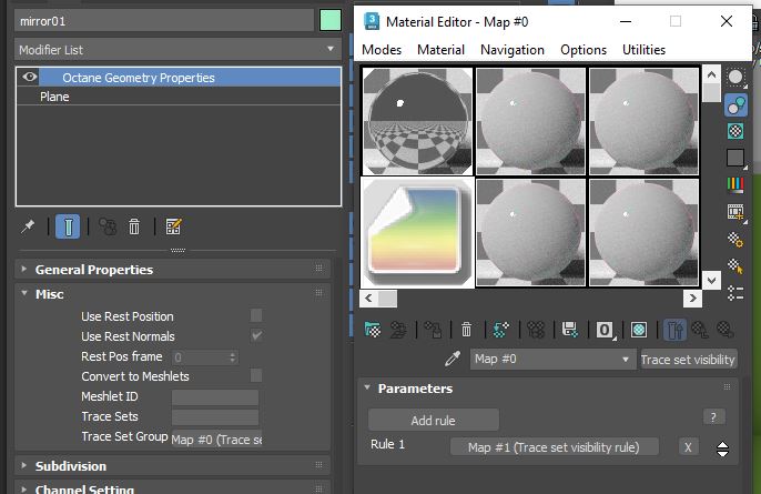

mirror01 has an Octane Geometry modifier with a Trace Set Group texture 'Map #0' (a 'Trace set visibility group' texture)
'Map #0' has a single rule : Map #1 (a 'Trace set visibility rule' texture)
'Map #1' has the 'red' keyword, matching the keyword of Sphere001
All the bounce types are enabled, but in this case, the Reflection is the one that prevents the rays from the sphere to be reflected in the mirror.

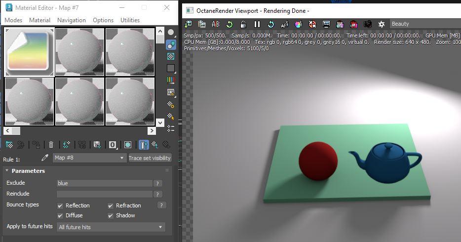

TraceSet_Sample2_CastShadow.max
The Teapot002 has a modifier with the keyword 'blue'
The Box001 has a modifier with a rule (group Map #7, rule Map #8) that exclude 'blue'.
All the bounce types are enabled, but in this case, the Shadow is the one that prevents the shadow rays from the teapot to be cast by the box.

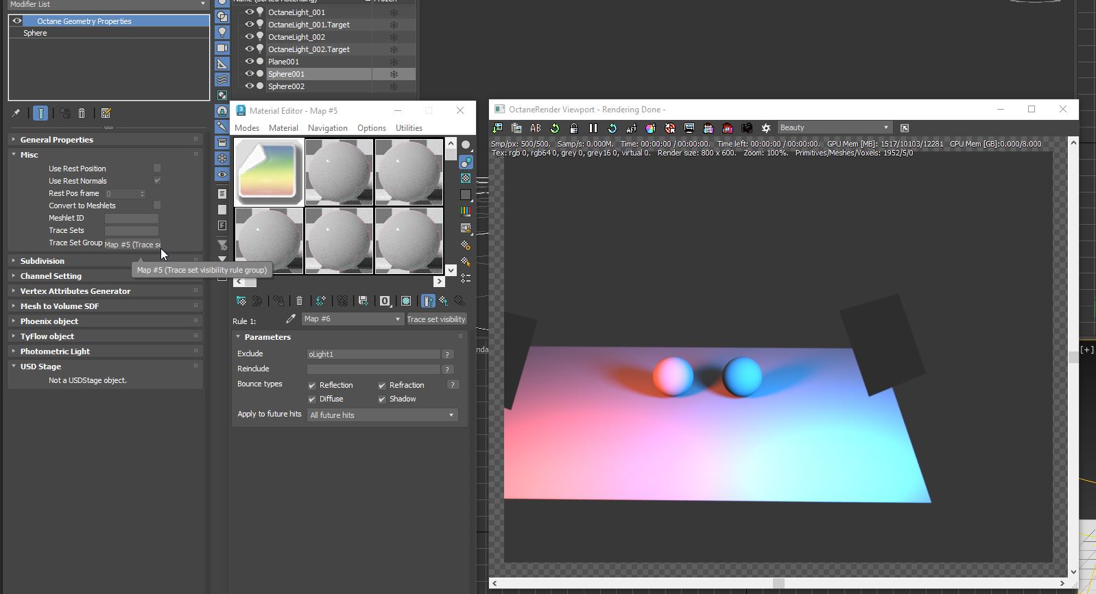

TraceSet_Sample3_light.max
OctaneLight_001 (emitting a red color) has a modifier with the keyword 'oLight1'
The sphere on the right, Sphere001, has a rule (group Map #5, rule Map #6) that exclude 'oLight1'
All the bounce types are enabled, but in this case, the Shadow is the one that prevents the red color from OctaneLight_001 to be received by the sphere.
Sphere001 only receive light from the blue light (OctaneLight_002)
Sphere002 has no visibility rule, and receive both blue and red lights.
