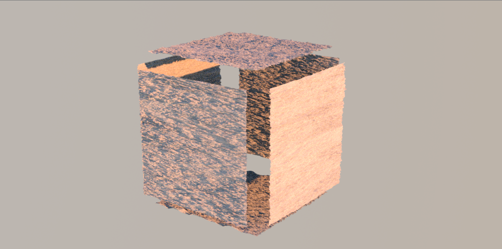

New Real Time Per-Pixel Texture Displacement
Octane's texture displacement system is being given a complete overhaul. The quality of the displaced surface, especially with high frequency input data has been much improved. It is also now possible to use OSL textures directly with texture displacement.
The implementation in Octane still has several issues left to solve, including feature interoperability, the Metal implementation, UV mapping, and most importantly, there has been no performance optimizations yet. VRAM consumption in this alpha is far heavier than it will be with the next set of changes. Please also note that you must use a Mesh UV projection in the input texture, at the moment. We are planning for this requirement to be lifted when we get to stable.
Note that at least in this version, old scenes using texture displacement will continue using the old method for compatibility issues, if you wish to switch to the new mode you must change the node's compatibility mode to use the latest approach.

tombyrom wrote:Nice! I just tested the new displacement feature on an RTX 4090, one 8k material from Quixel on a simple imported plane and it completely locks up on anything over a 1024x1024 displacement texture, is that expected currently? The viewport becomes unusable and renders 1 sample every 30+ seconds or more. Memory usage is fine, only using 13gb according to GPUZ
Same issue on my system. The displacement is usable on 1k textures. Everything above starts to slow down viewport considerably.
Old displacement system is really smooth with 8k textures.
Moreover the displacement still breaks the geometry apart.
