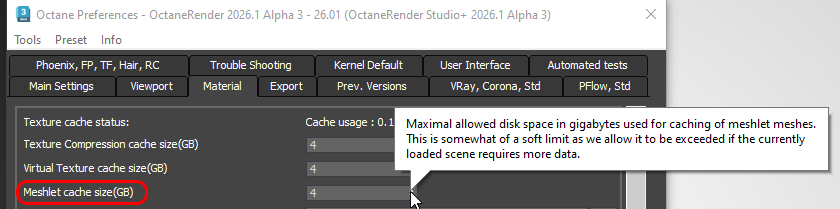

Meshlet cache size:
Use Octane Preferences: Material tab:
Select the size with the parameter 'Meshlet cache size (GB)'

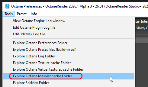

Meshlet cache location:
Use Octane Preferences: menu Tools/Explore Octane Virtual textures cache Folder to open Windows explorer.
This should be a folder like C:\Users\xxxxx\AppData\Local\OctaneRender\cache\vtex
You can delete those cache files, but you may need to close 3dsMax when files have been used.

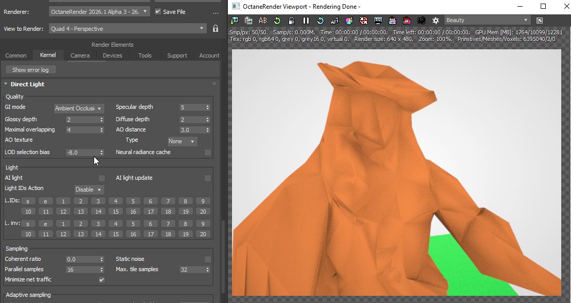

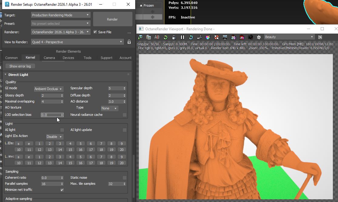

Note: While rendering, you should notice that the first few frames are rendered with a lower resolution mesh.
'LOD selection bias' has been added to influence the LOD data selection. (Render settings, Kernel tab, render Kernel rollup (eg Direct Light))
Decreasing its value, will make the loaded LOD data cruder, increasing its value will make the loaded LOD data finer. The default is 0.
Here are some results with values 0, -5, -8
