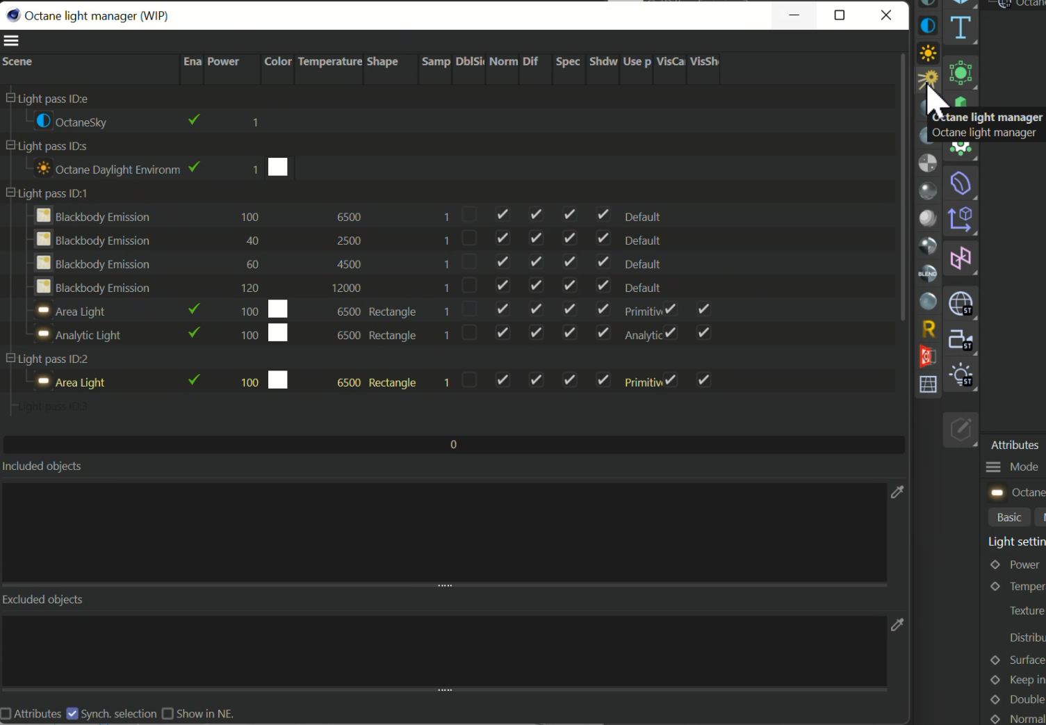

Posts: 10484
not exactly the same, but you can try to use the Octane Light manager to see at a glance all the active emissive nodes in the scene, even in materials, and select them for editing:
ciao,
Beppe
