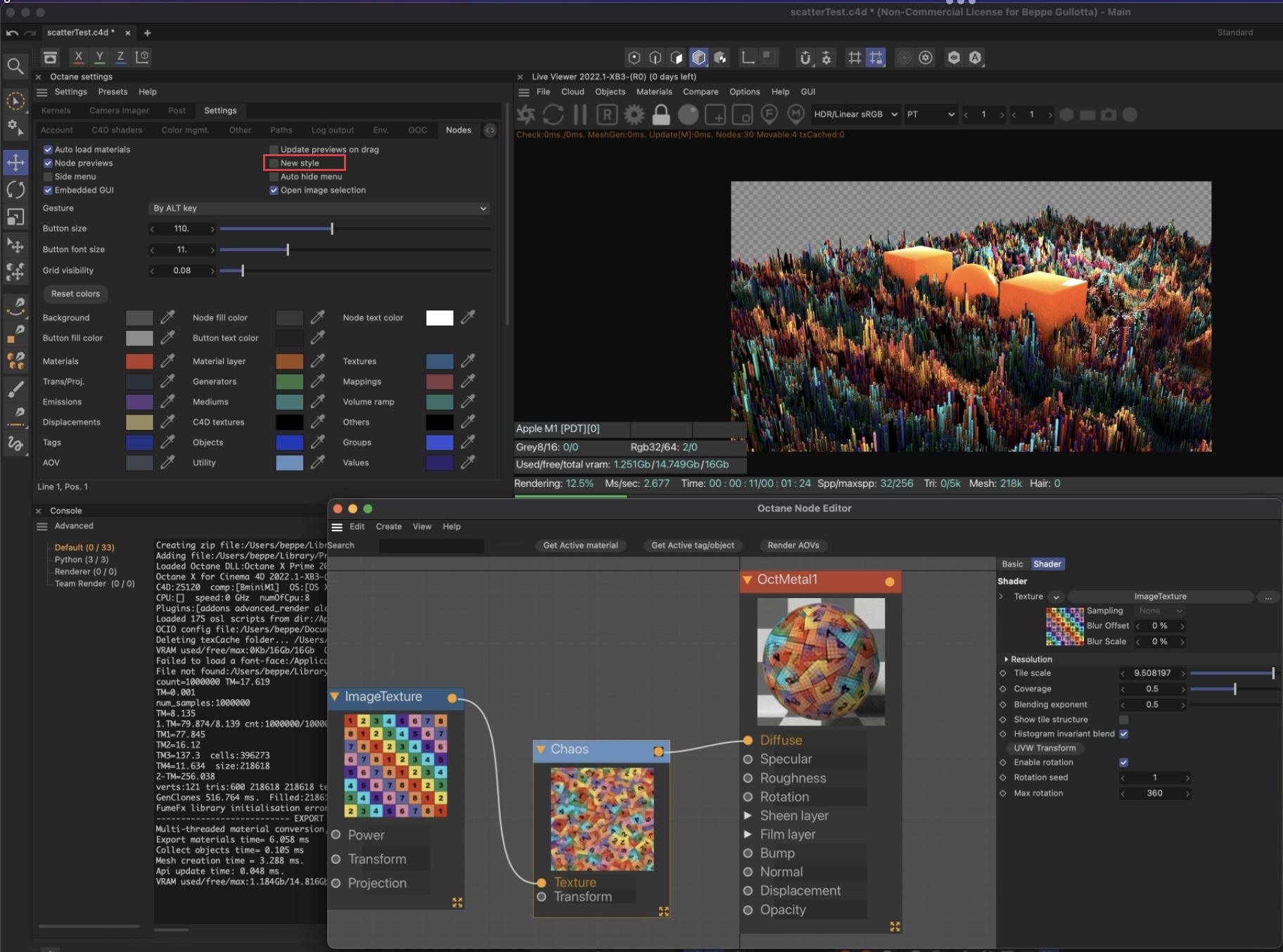

First of all, please go to Octane Setting/Nodes, and disable the New style option, or material preview doesn't work in node editor:

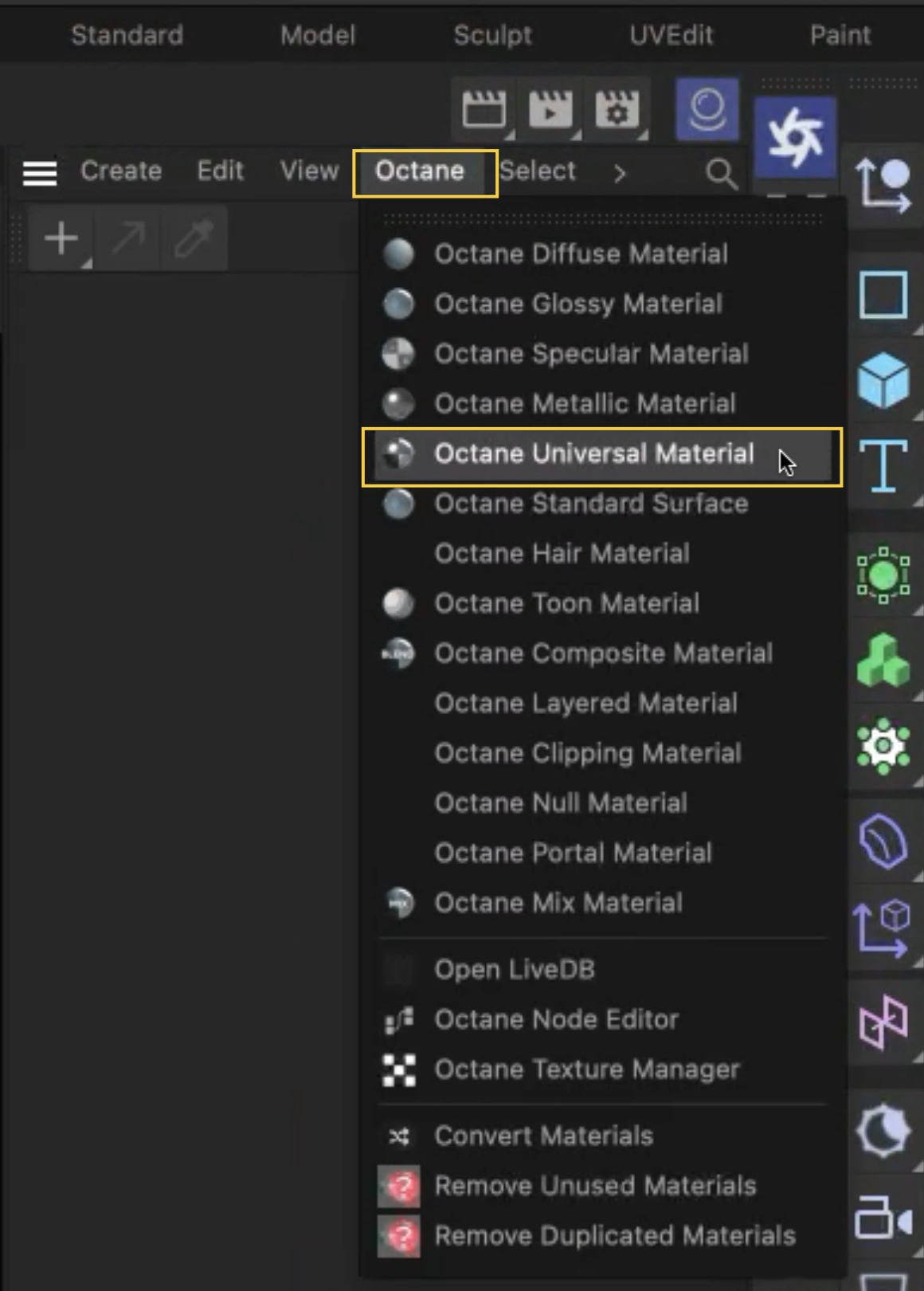

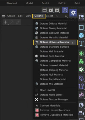

Then please go to C4D material manager and create an Octane material from Octane menu:

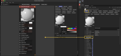

Then, in Attribute editor go to the Basic tab and press the Node Editor button:
