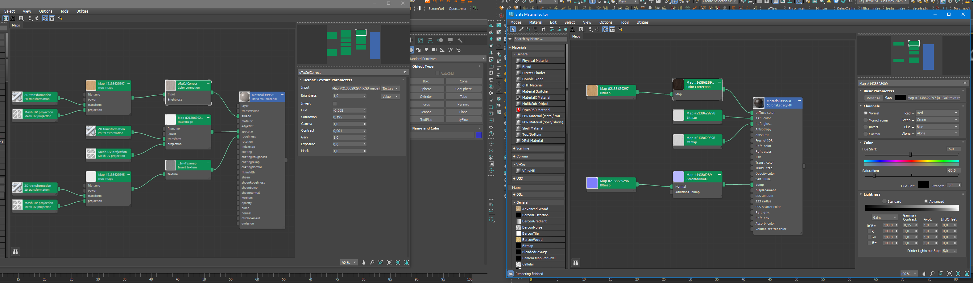

does not convert correctly Vray-Corona to Octane
- Elvissuperstar007
- Posts: 2603
- Location: Ukraine
- Contact:

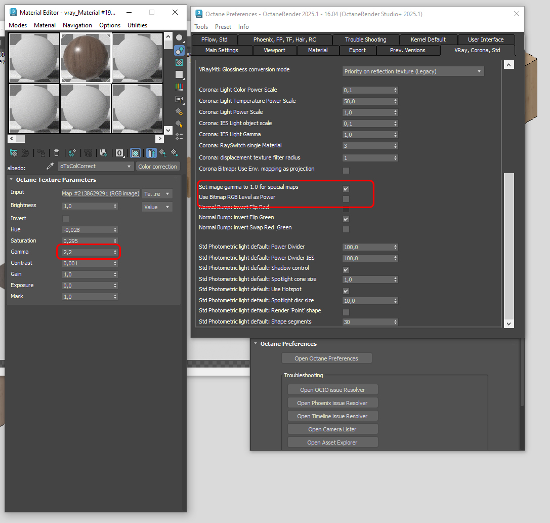

color correct octane does not match color correct standard,
well and normal map does not convert

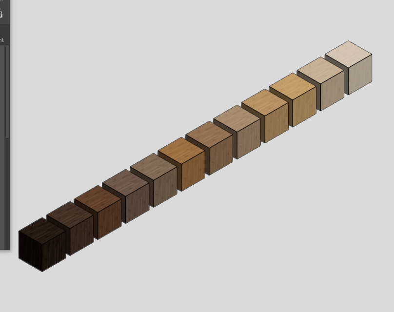

I checked this on other models, octane does not convert Color Correction correctly at all, it becomes light

Hi Elvissuperstar007,
I'm noticing some potential issues with the gamma settings during the conversion process. It seems like something might not be working as expected, either in the way the conversion is handled or in the default values set in the corresponding window. I'm running a few tests before reaching out to the developers. Adjusting the albedo gamma to 2.2 definitely improves the outcome, but it doesn't seems to be not the only parameter affecting the problem.
Regards
Paride
