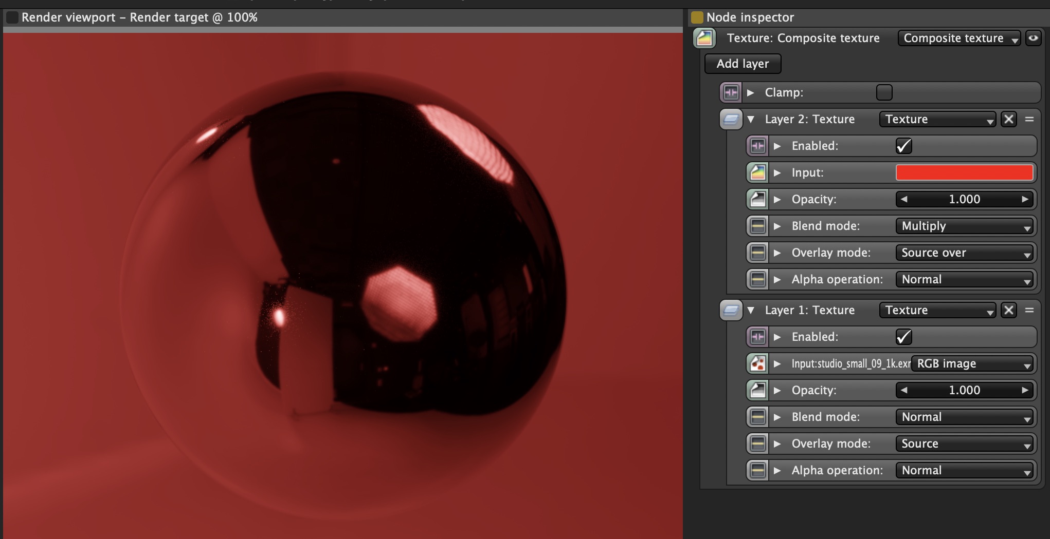

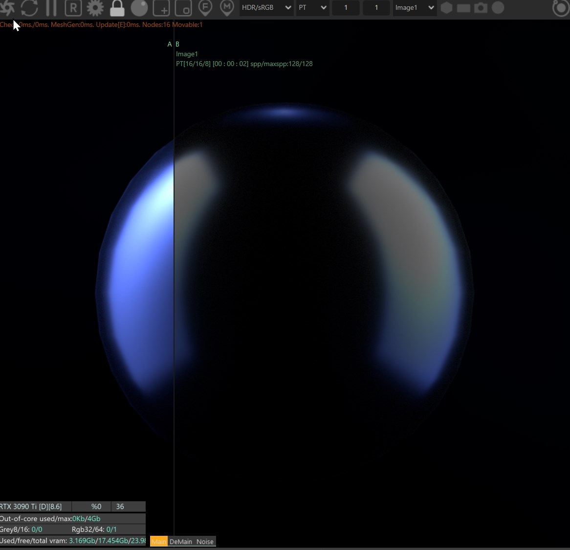

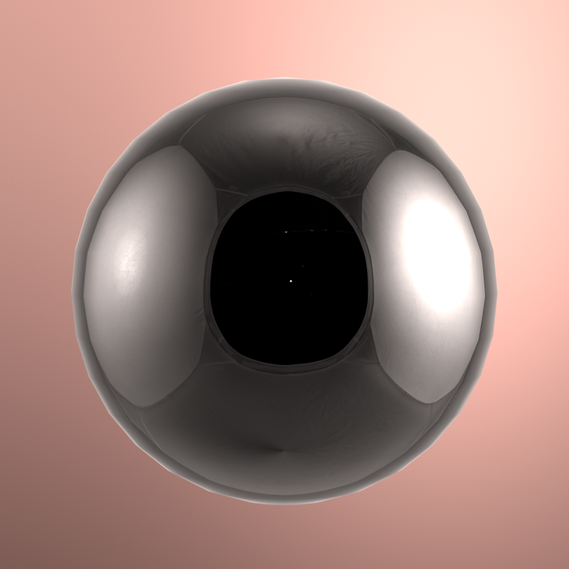

Today, I wanted to change the overall color of an HDRI map using the Composite Texture node (since I wanted to add additional processes other than just a color change). I added two texture nodes: one for the HDRI and one for the RGB Spectrum. I set the blending mode of the first texture node (RGB Spectrum) to Multiply.

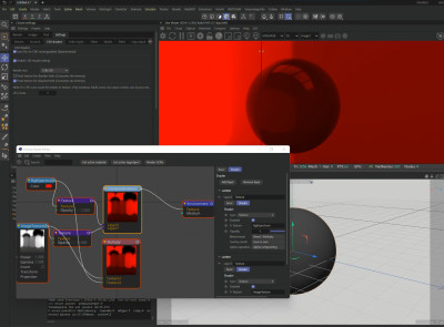

However, I realized that the brightest areas were dimmed. I couldn't fix that, so I tried using the Multiply node, and I got the correct mix.
Why is there a difference between the two Multiply operations, as you can see below:
CompositeTexture+Multiply Blend
Only_Multiply_node

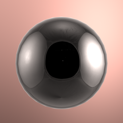

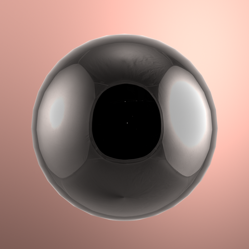

Sorry, but I cannot reproduce the issue, the result is the same with both setup here:
Do you mind to share your scene with assets?

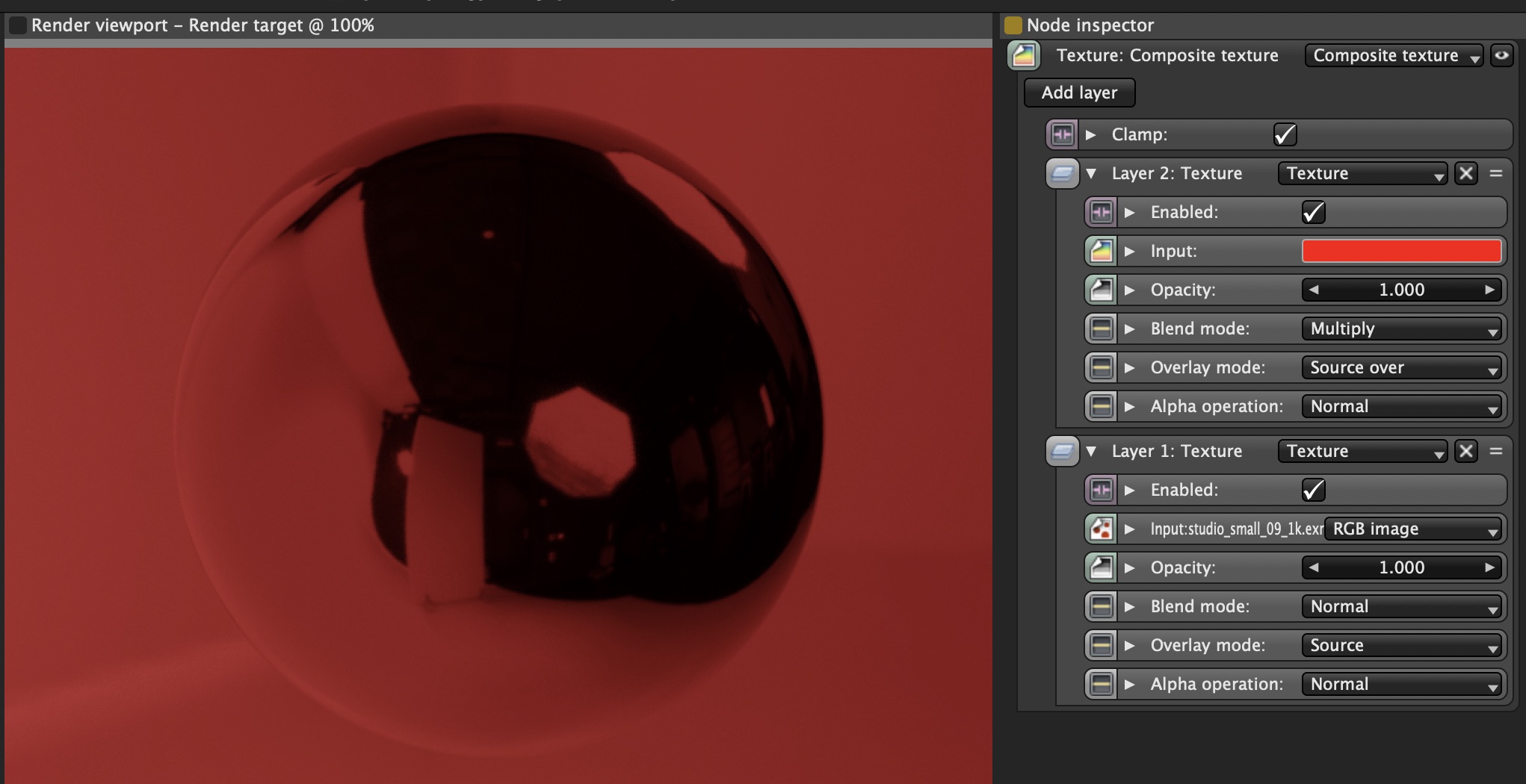

@skientia, it's good to hear about that option! I was surprised that the C.Texture node had it because I spent about two hours on this issue. After reading your answer, I tried it, but I couldn't find any clamp option. I hope it's there somewhere and I just couldn't find it...

Confirmed, thanks skientia, the Clamp parameter is not exposed, and will be fixed in one of the next updates.

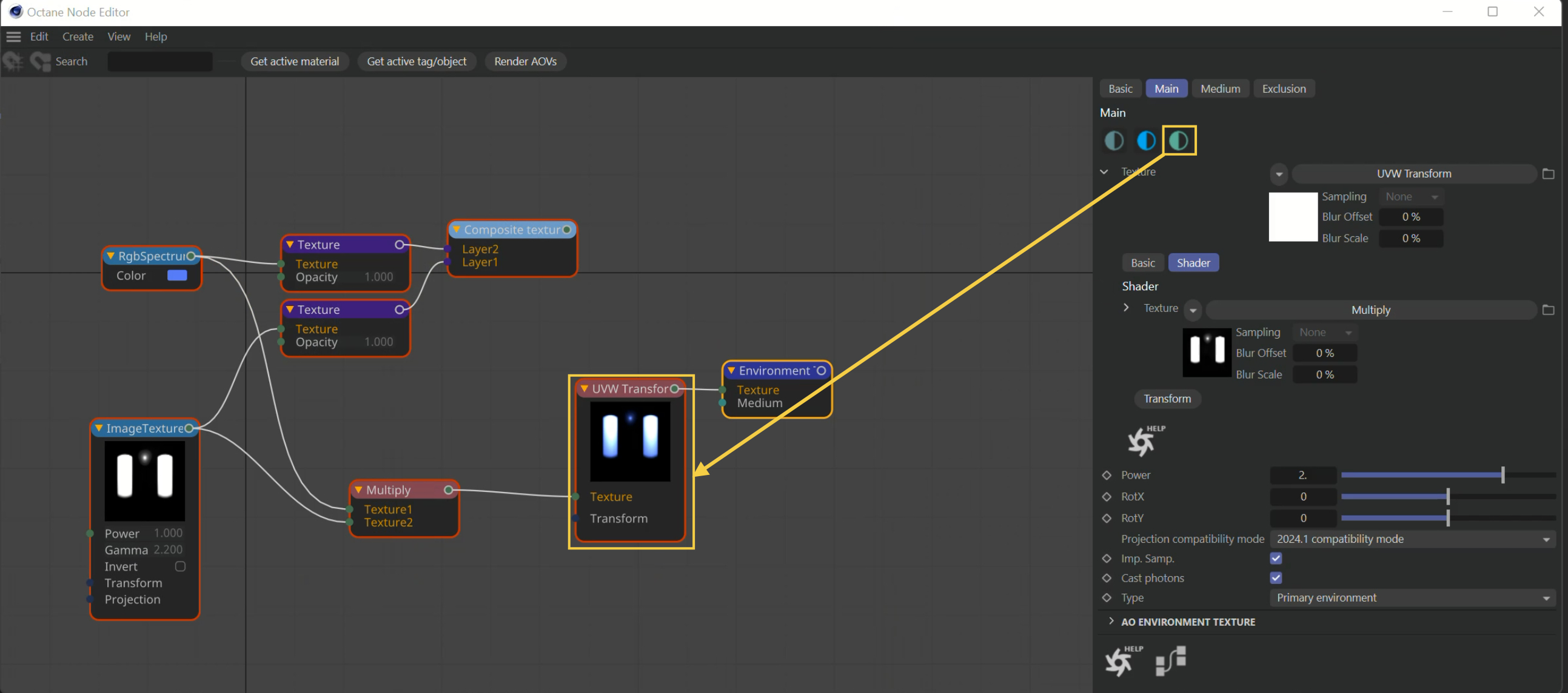

On that note, I’d also like to mention that it would be great if the RotX and RotY sliders continued to function even after adding another node after the Image Texture or Bitmap node.
Posts: 10475
Hi Delizade,
great to hear my suggestion was useful!

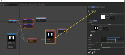

About RotX/ RotY, just click on the green icon to create an UVW Transform node that plugin can rotate:
