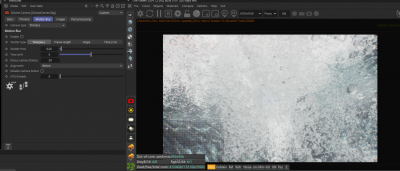

Hi All,
I got a scene with with the ABC animation file. One of them is from an xparticles vdb mesh and the other one is a thinking particle bake that controls a cloner.
It is an underwater scene in a swimming pool so a lot of refraction, reflection is happening.
The scene renders well in the first 50 frames, after that the render time jumped up from 13 minutes to 2h 40 minutes.
I tried to troubleshoot it and the following happens.
When I start the render from frame 50, the first frame renders well, but the 2nd jumps up. and whichever frame I start the render from the first frame renders correctly, but the second jumps up. I tried with multiple frame, 54, 58, 60. All give me the same result.
I am uploading the project here, should be ready in an hour or so if you would like to have a look.
https://www.dropbox.com/scl/fo/jzz7m67x ... cmx95&dl=0
Thank you for the help!
Mihaly

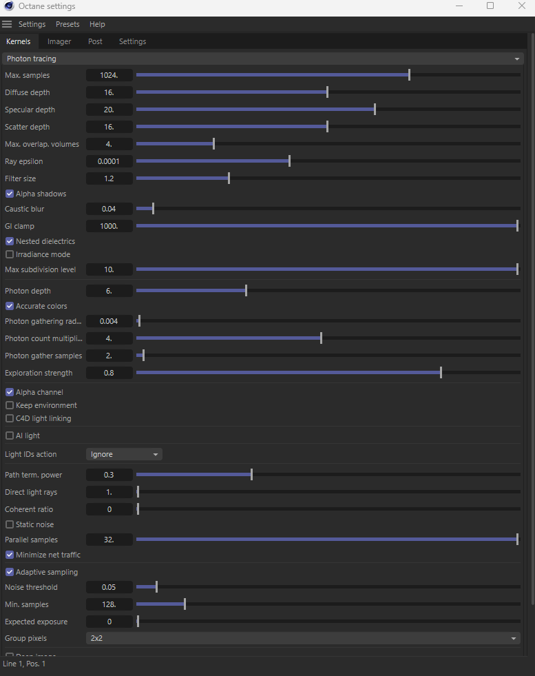

I narrowed the issue down a bit.
It seems to me that it is related to the motion blur.
When I switch it off it renders well. I switch it back on, still renders well. I step one frame. The render time jumps up again.
