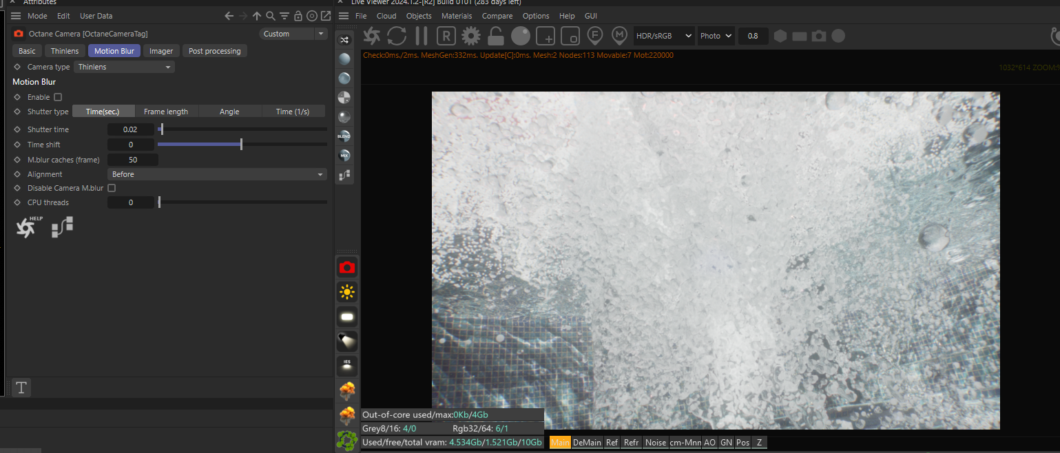

Something is not ok with the motion blur and cloner/particles.
The motion blur works with no issues until about frame 50-53 after that the render time jumps up with 15-20 times.
I start the render from frame 54, first frame ok, the next one is a total mess.
Then I start the render from frame 55, that is ok, the next one is not.
I found another post regarding a similar issue and @Aoktar suggested to push up the cpu threads under the octane camera tag, motion blur tab.
But it seems it is not working, or I am doing something wrong, as I tried to set it to 8, 12, 16, 24, but after I click away and go back to the tag, I find the cpu thread slider jumping to 0 every time.
