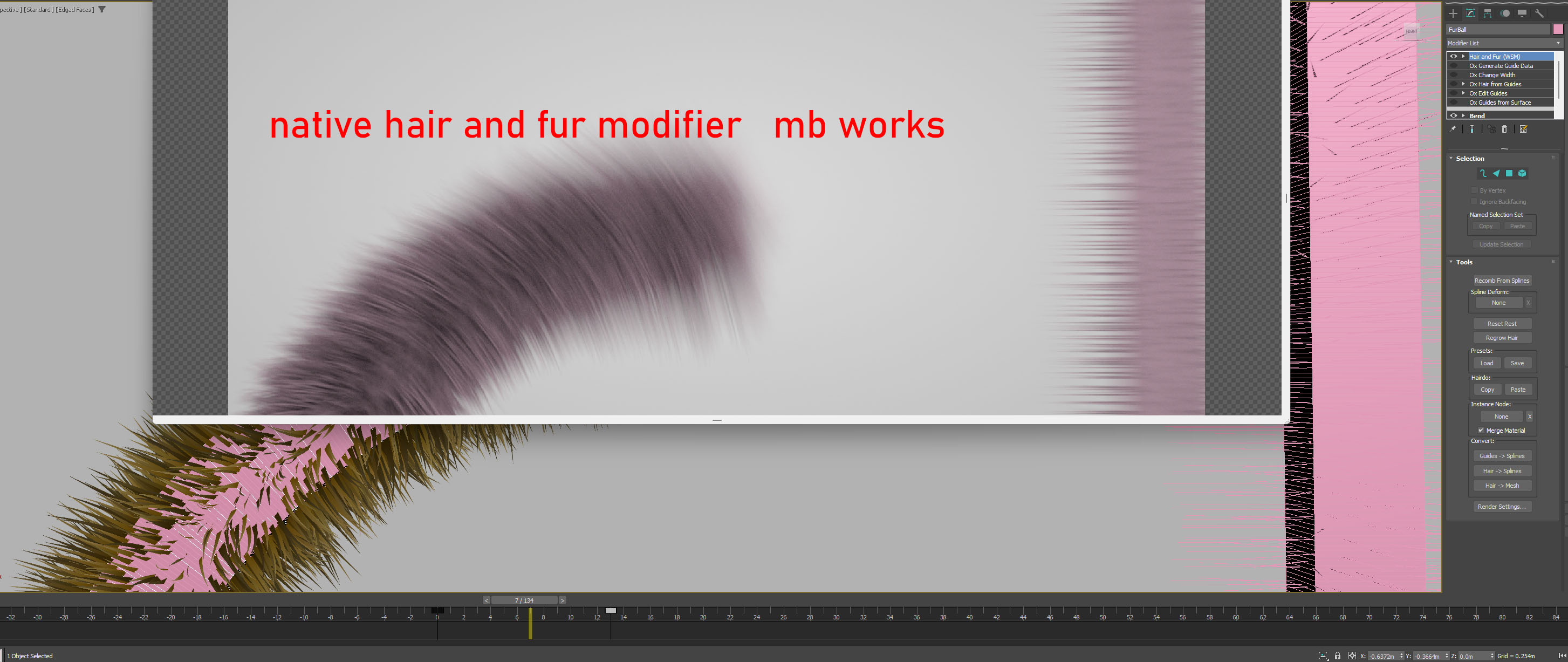

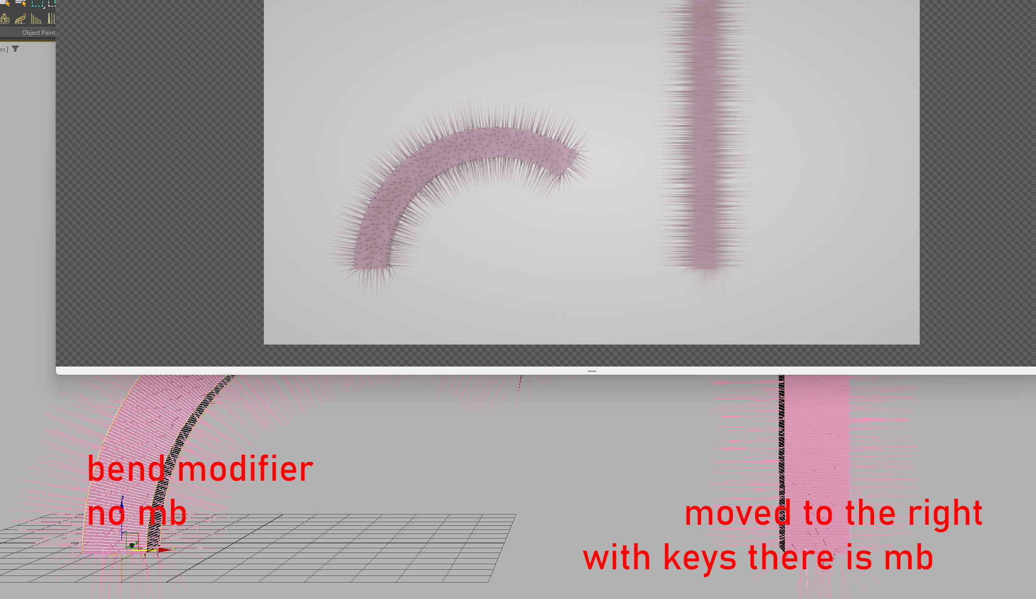

Thank you! Now we just need help with motion blur not working.paride4331 wrote:Hi coilbook,

- paride4331
- Posts: 3997
Hi coilbook,
The developers have identified an issue with frame calculations in Ornatrix, particularly with larger 3ds Max frames. As a temporary workaround, you can adjust the 'offset' of the Octane proxy around the time you want to render (e.g., setting it to 400). This issue may return for frames beyond 400. The team is still investigating the issue and will provide updates asap.
