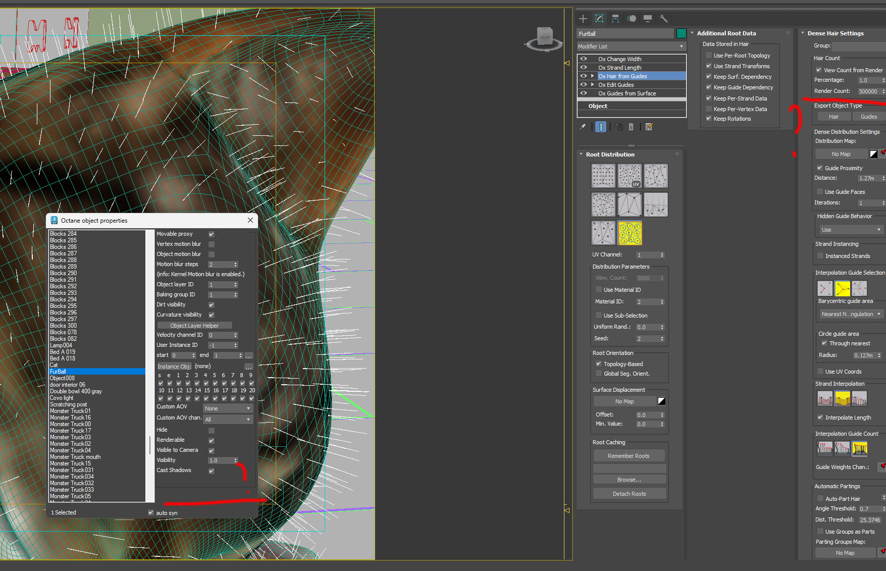

It looks like render count doesn't work and octane only renders view count. What should I do? I view count to have 1000 hairs but render millions. Thanks
And use render mode in octane properties is gone

Hi coilbook,
Is your issue similar to this one?
viewtopic.php?f=27&t=82790&p=430113&hil ... ix#p430113
Regards
Paride

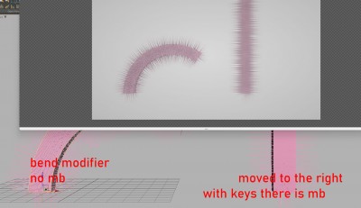

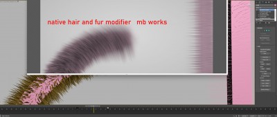

Thank you! Now we just need help with motion blur not working.

paride4331
Posts: 4003
Hi coilbook,
The developers are looking into this issue that occurs.
Regards
Paride
paride4331
Posts: 4003
Hi coilbook,
The developers have identified an issue with frame calculations in Ornatrix, particularly with larger 3ds Max frames. As a temporary workaround, you can adjust the 'offset' of the Octane proxy around the time you want to render (e.g., setting it to 400). This issue may return for frames beyond 400. The team is still investigating the issue and will provide updates asap.
