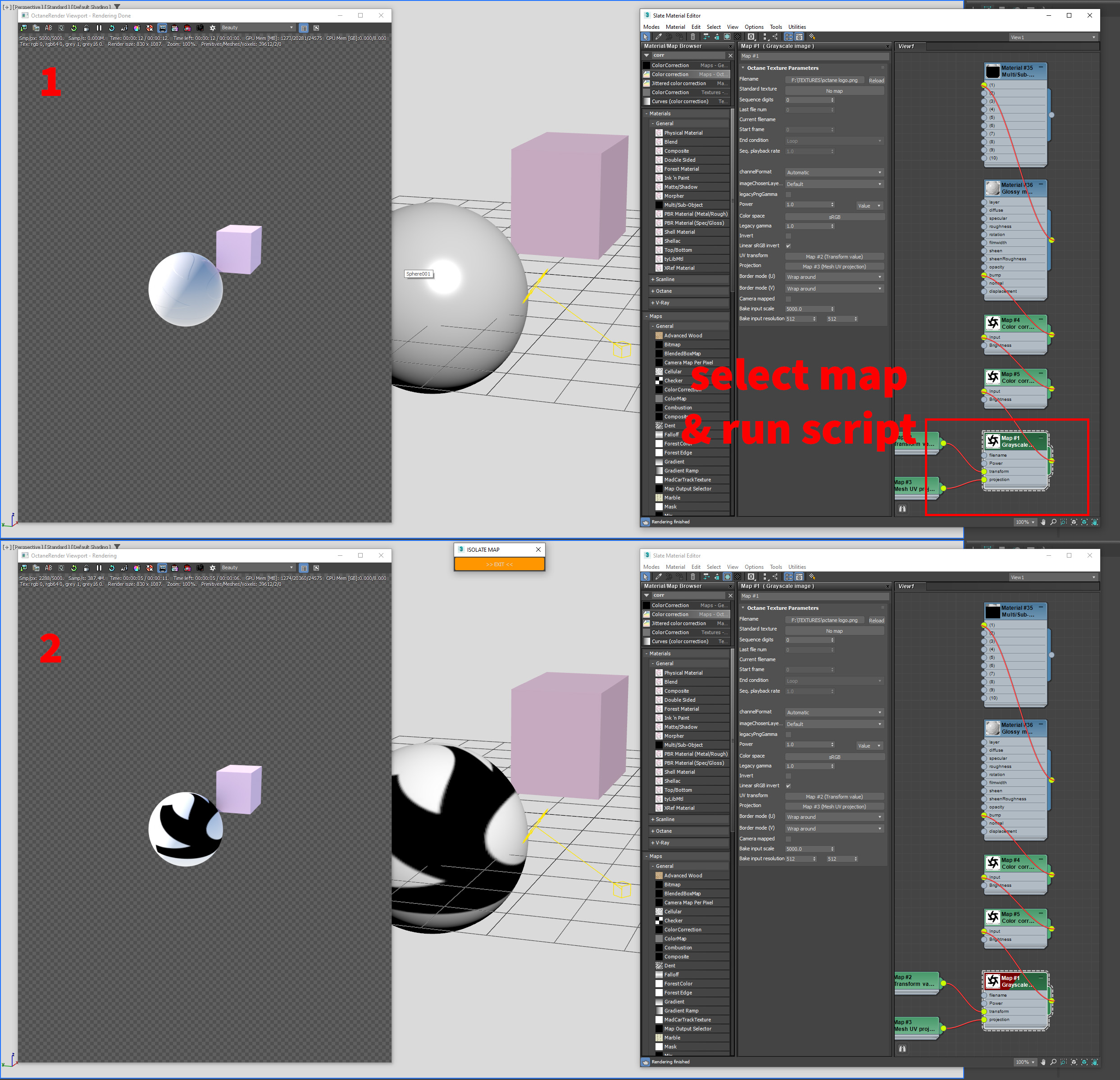

I wanted to mimic the solo node in c4d.
As always I made a frankenstein style script but it works ( at your own risk )
I made a macroscript you'll find in "yoko" category ( I bind it to ctrl+alt+s key as I don't use incremential save )
Just select the node you want to isolate, run the script.
If your octane viewer is opend you can see the node ( map or noise or...) on your object
You can refine your setting then click EXIT.
If anybody can enhance the script he is welcome :-)
Better not to have Quick update mode on.
ISOLATEmap.zip
(1.02 KiB) Downloaded 157 times

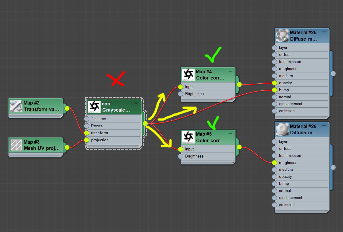

Infortunately when the map is used several times it don't work... hope somebody ( neonZorglub ? ) can do far better :-)
