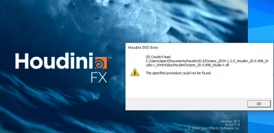

I'm having issues with the plug-in installation. I have version 20.5.278 of Houdini. Is this version correct of the plug-in I should use (Octane_2024.1.2.0_Houdini_20.0.896_Studio+_Win64).
Because after installing I get these weird messages trying to open up octane plugin. See attachments
When I first opened Houdini

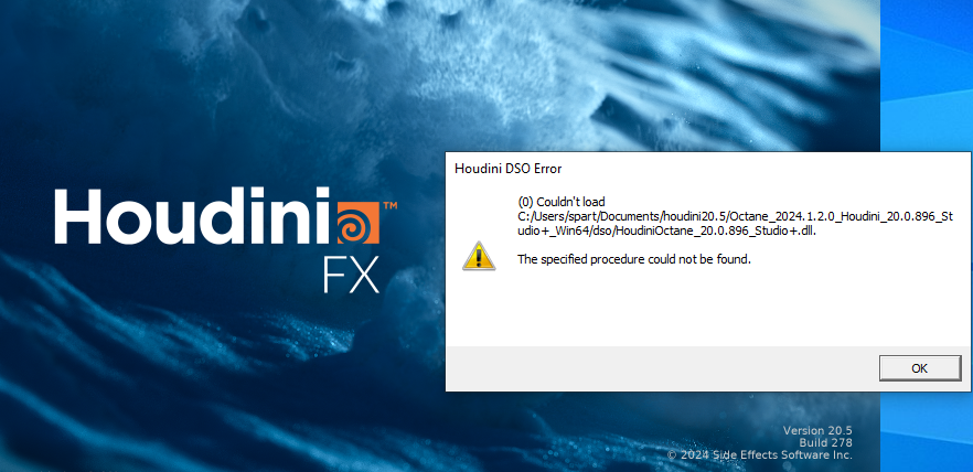

When I try to use Octane in Houdini

Also this is what I put in the houdini.env file at the bottom.
PATH = "C:\Users\spart\Documents\houdini20.5\Octane_2024.1.2.0_Houdini_20.0.896_Studio+_Win64/bin;$PATH"
HOUDINI_PATH = "C:\Users\spart\Documents\houdini20.5\Octane_2024.1.2.0_Houdini_20.0.896_Studio+_Win64;&"
HOUDINI_DSO_ERROR = 2
Thanks for your help in advance.

Hi there, your Houdini + Octane versions need to match.
Please consider upgrading to a newer production build like Houdini 20.5.370.
viewtopic.php?f=102&t=84382
Alternatively, you will have to use an earlier version of the plugin 2024.1.01 for Houdini 20.5.278.
https://render.otoy.com/customerdownloa ... _Win64.zip
We only support the last production builds for 19.5 and 20.0 and the last 3 production builds for the latest 20.5
