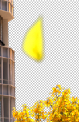

I am using 2024.1 R2/R3 c4d octane plugin and there is a visible alpha edge on Denoised Beauty. In older versions, this was not happening. I am saving in Octane Exr DWAB.
Any tip on what changed? Do I need to switch something on that I am not aware of? In older version 2023.1.2, the same settings, give correct results in both images.

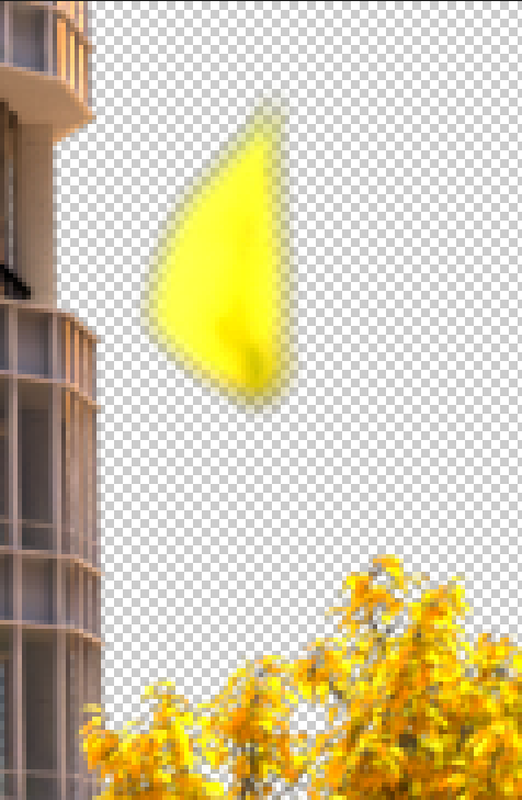

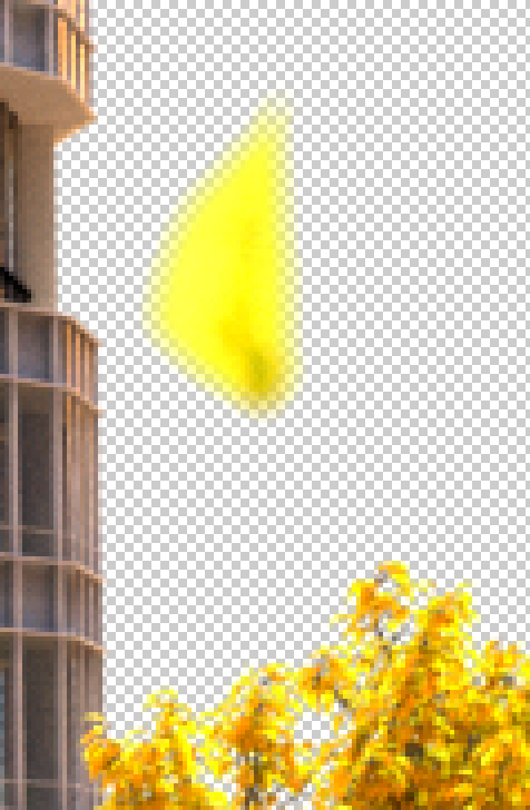

it doesn't matter if the Premultiplied alpha is set to "none" or "encoded", in both cases, the final alpha edge is darker in Denoised Beauty. This was not happening with older versions of octane. With default settings, Beauty and Denoised Beauty had exactly the same alpha on default settings.
I tried multilayered file save and single layers. In both cases, alpha in Denoised Beauty is handled differently as in Beauty.
Then I tried an older octane version and on default settings both images were identical. That means something is different in the newest Octane version. And I can't use Camera Imager/Denoiser till this bug is solved.

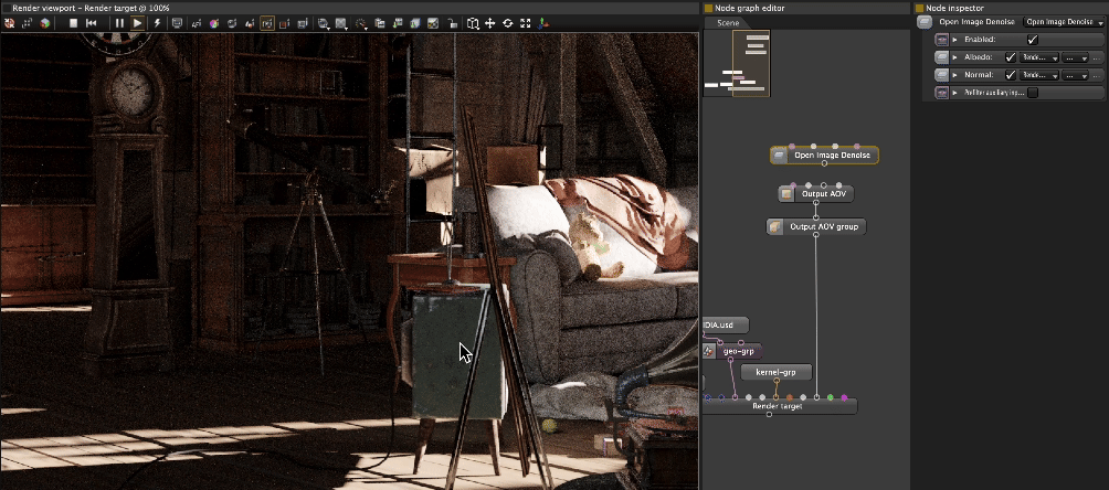

I am trying to find out if there is a way to use the new open Denoiser node on a Shadow and Light pass to denoise them ?
I looked at the image in this post and do not see how I hook up this feature to get the passes that are currently not denoised.... denoised :>)
Peter
Peter

About new Open Image denoiser and AOVs, please have a look at here:
viewtopic.php?f=30&t=83664#p433908
ciao,
Beppe

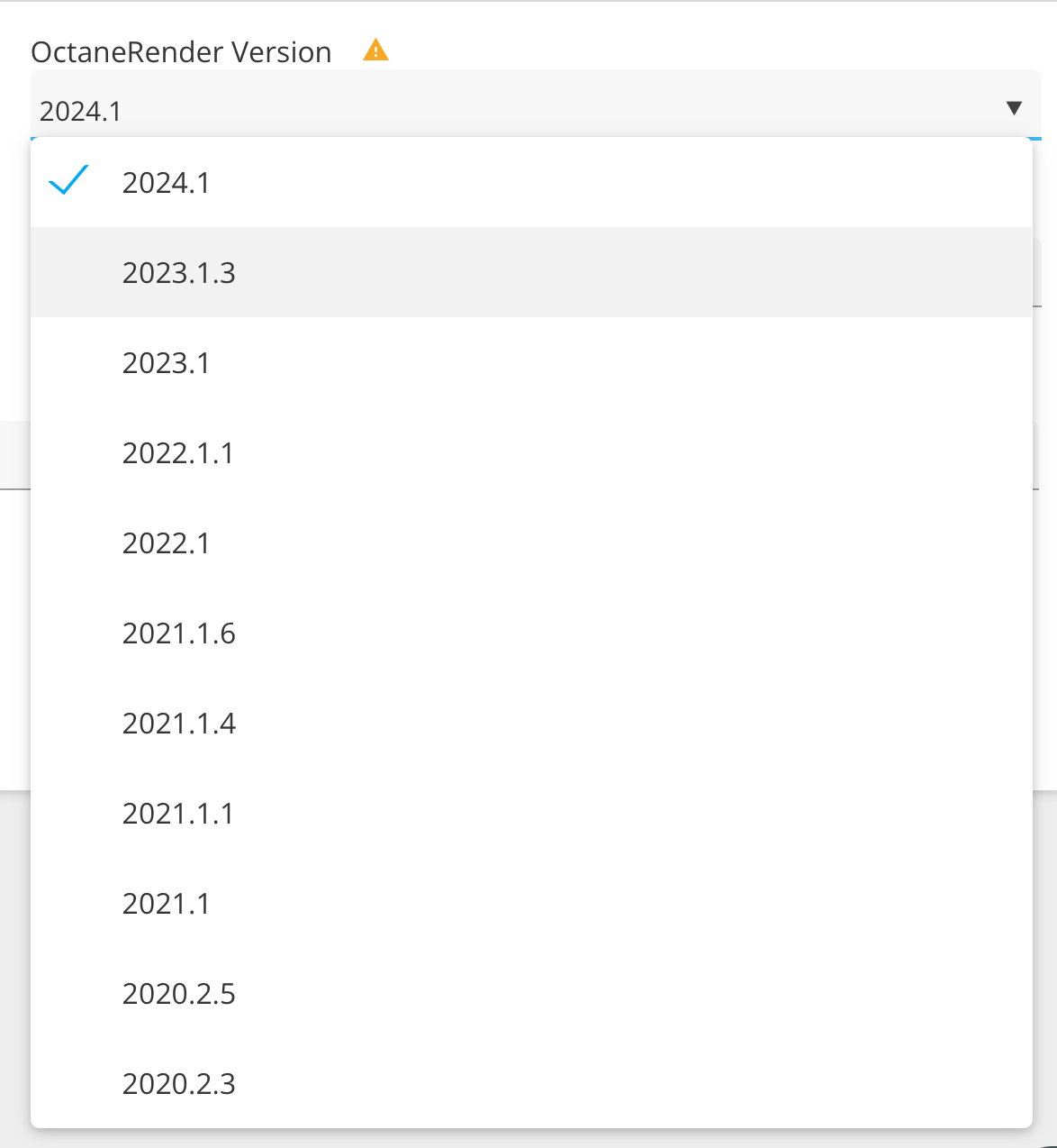

I also raised this with Render Network support yesterday (request 280783) and they've been looking into the issue.
I can see a new version has been added to the network options overnight (2025.1.1), so I’ve just tested the 2025.1.1 setting with my existing file (from C4D 2024.4.1).
I can only see 4 options in my Render Network settings (see below - I tested the previous 3 yesterday with same transparency results).
2025.1.1 is still having the same issues for me (with darker alpha edges on output) using Render Network Wizard 1.03.
Job ID: fc148a9e-bed4-4614-8483-1186cf4be30f
I’m waiting to test an ORBX export from the same file, which I believe will produce the correct transparency results, as it did with a different test yesterday (although not a viable workflow for me, as my ORBX file size is very large (even zipped) versus 280mb from the wizard export file). Currently processing Scene ID: 7e46e8cc-cb5f-4eff-8992-83594d2f29ae
I’ve just installed C4D version 2025.1.2, with studio plugin 2024.1.2, Render Network Wizard 1.03, but unfortunately using RNDR 2025.1.1 setting, I'm still getting the same alpha edge issue. Job ID: dbfbfef9-f84b-4fec-828b-7894609dec22
