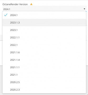

@m0dm0d:
the issue with render network is that it is currently based on 2024.1 SDK, while the denoised alpha fix has been introduced in 2024.1.1 SDK, so it is not available on render network yet.
Please try to render your scene with 2023.1.3 version on render network and report back, thanks:

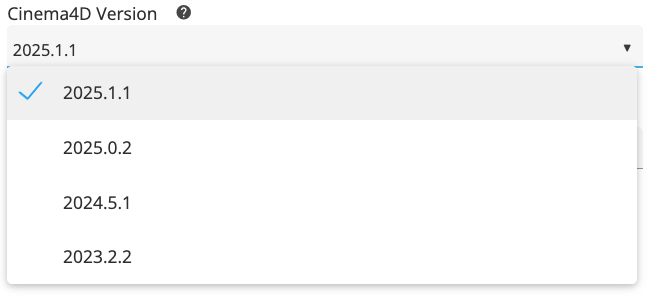

I also raised this with Render Network support yesterday (request 280783) and they've been looking into the issue.
I can see a new version has been added to the network options overnight (2025.1.1), so I’ve just tested the 2025.1.1 setting with my existing file (from C4D 2024.4.1).
I can only see 4 options in my Render Network settings (see below - I tested the previous 3 yesterday with same transparency results).
2025.1.1 is still having the same issues for me (with darker alpha edges on output) using Render Network Wizard 1.03.
