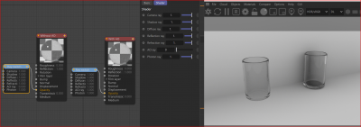

Internally, Octane considers AO and Refractive Rays as different categories of illumination. Octane Glass/Specular Materials by default allow Refractive Rays to pass, but not Ambient. I suggest you use the Ray Switch node in the Opacity channel of your glass material to make it at least partially transparent to AO rays. Depending on the color/thickness of your glass, you may need to experiment with what value between 0-1 looks correct to your eye.
RaySwitch Glass Without and With AO

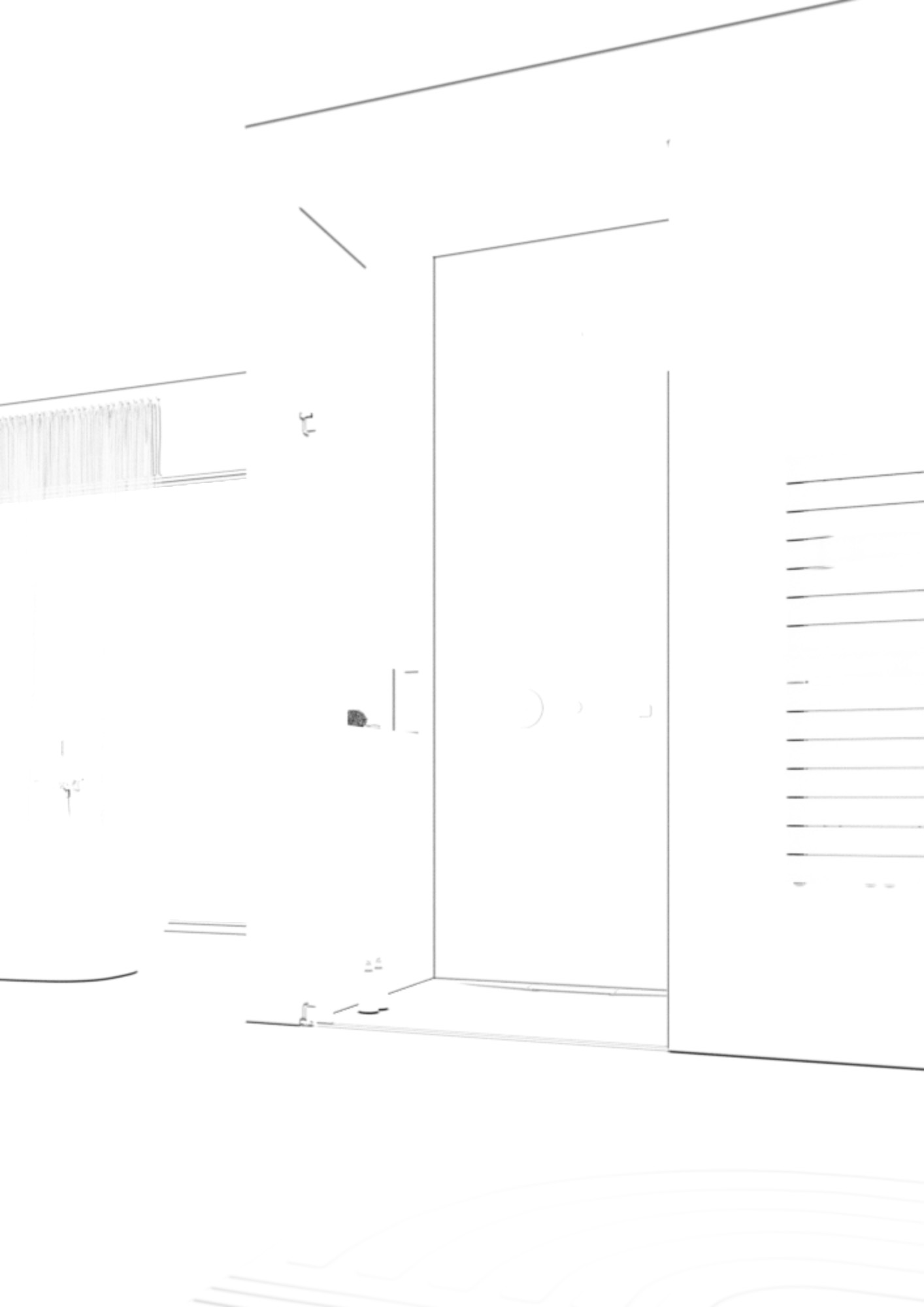

Ambient Occlusion should be multiplied in Photoshop as an extra layer.
I hope the pictures make it more understandable - it's about AO behind the glass - not in the glass.
AO with no Glas
AO with no Glas
AO not behind Glas
AO not behind Glas
