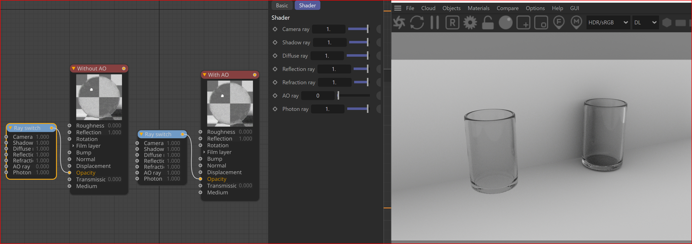

Internally, Octane considers AO and Refractive Rays as different categories of illumination. Octane Glass/Specular Materials by default allow Refractive Rays to pass, but not Ambient. I suggest you use the Ray Switch node in the Opacity channel of your glass material to make it at least partially transparent to AO rays. Depending on the color/thickness of your glass, you may need to experiment with what value between 0-1 looks correct to your eye.
RaySwitch Glass Without and With AO

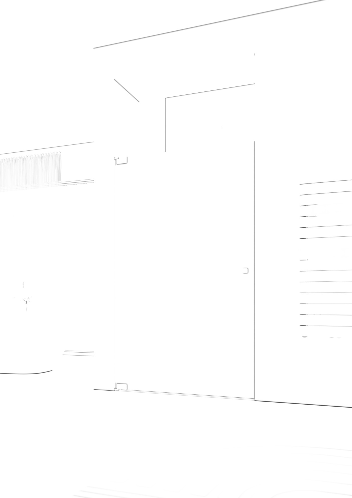

Ambient Occlusion should be multiplied in Photoshop as an extra layer.
I hope the pictures make it more understandable - it's about AO behind the glass - not in the glass.
AO with no Glas
AO with no Glas
AO not behind Glas
AO not behind Glas

Under the assumption that AO AOV is used as the "shadow-booster technique", and given the lack of single-checkbox option for this scenario, compositing is seemingly the most straight forward approach to have such control in post with necessary AOVs and masks.

Ah, I thought you were trying to avoid compositing all together and wanted control of the AO through the glass surface.
