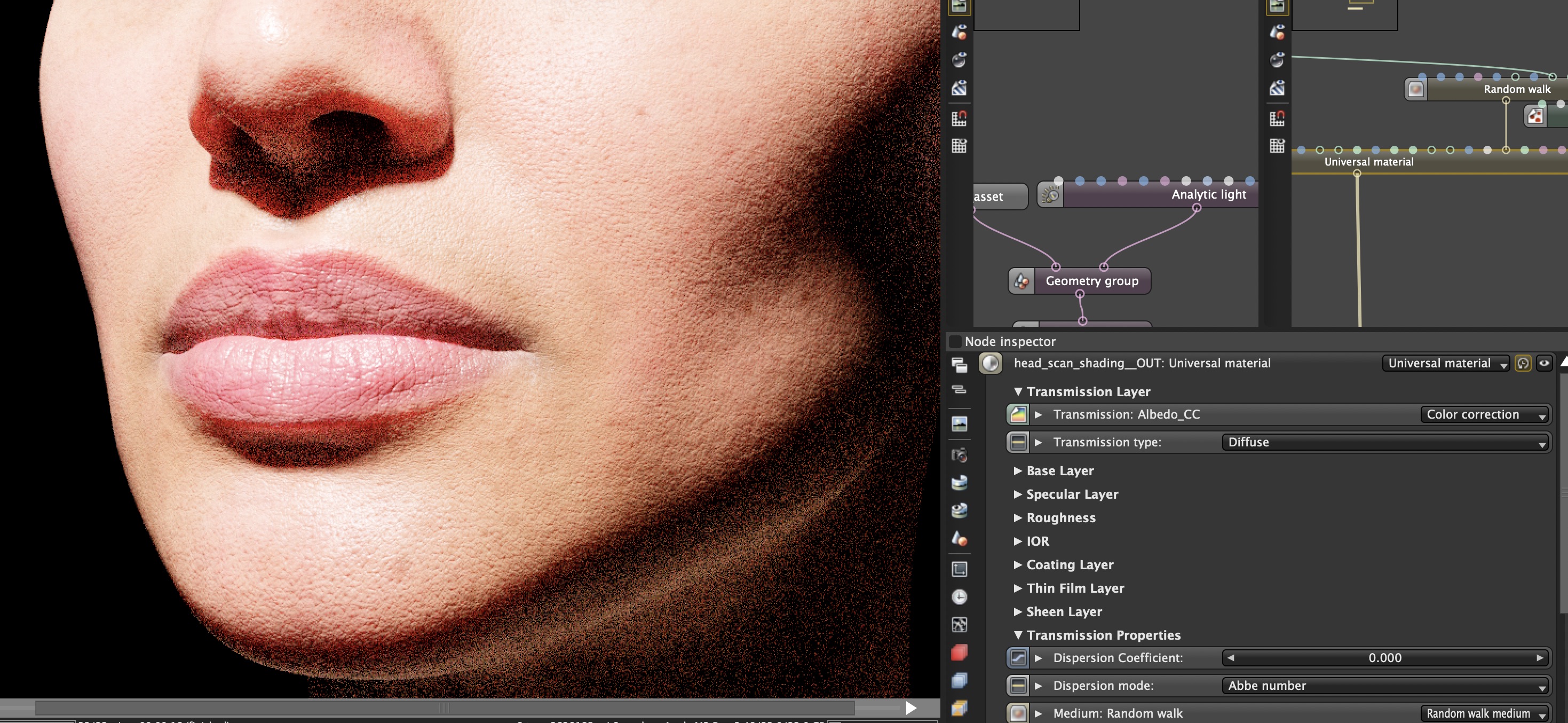

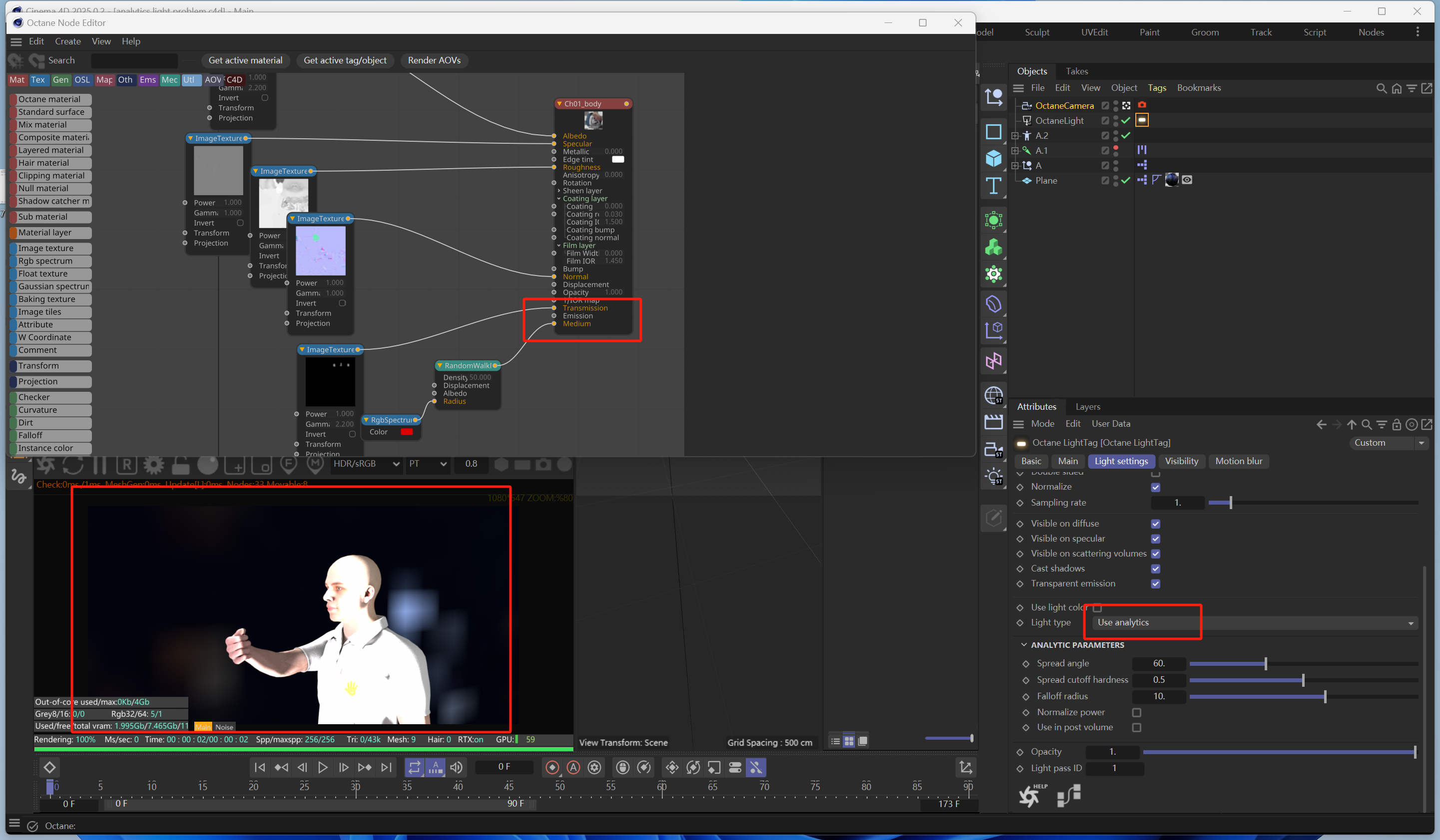

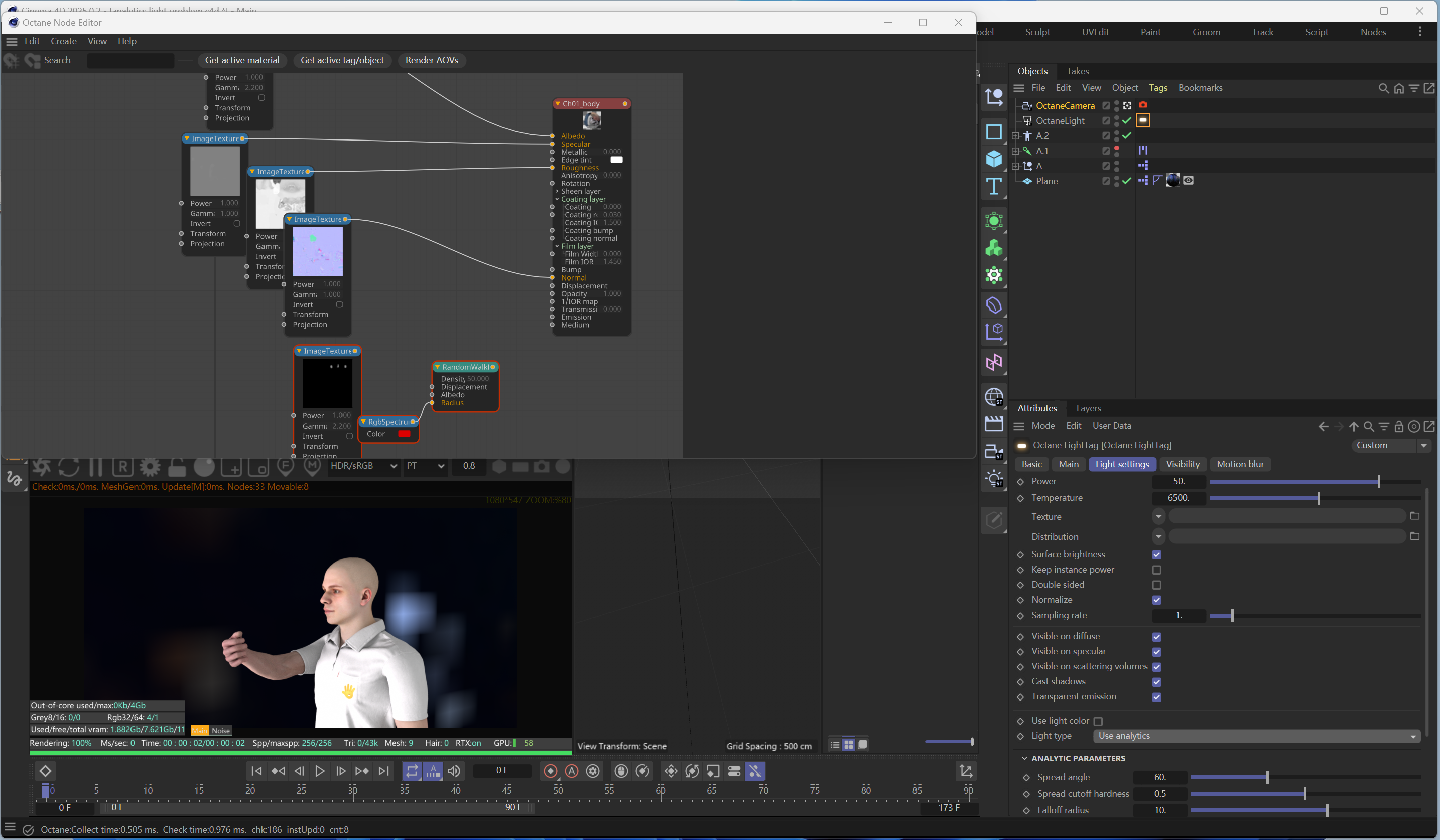

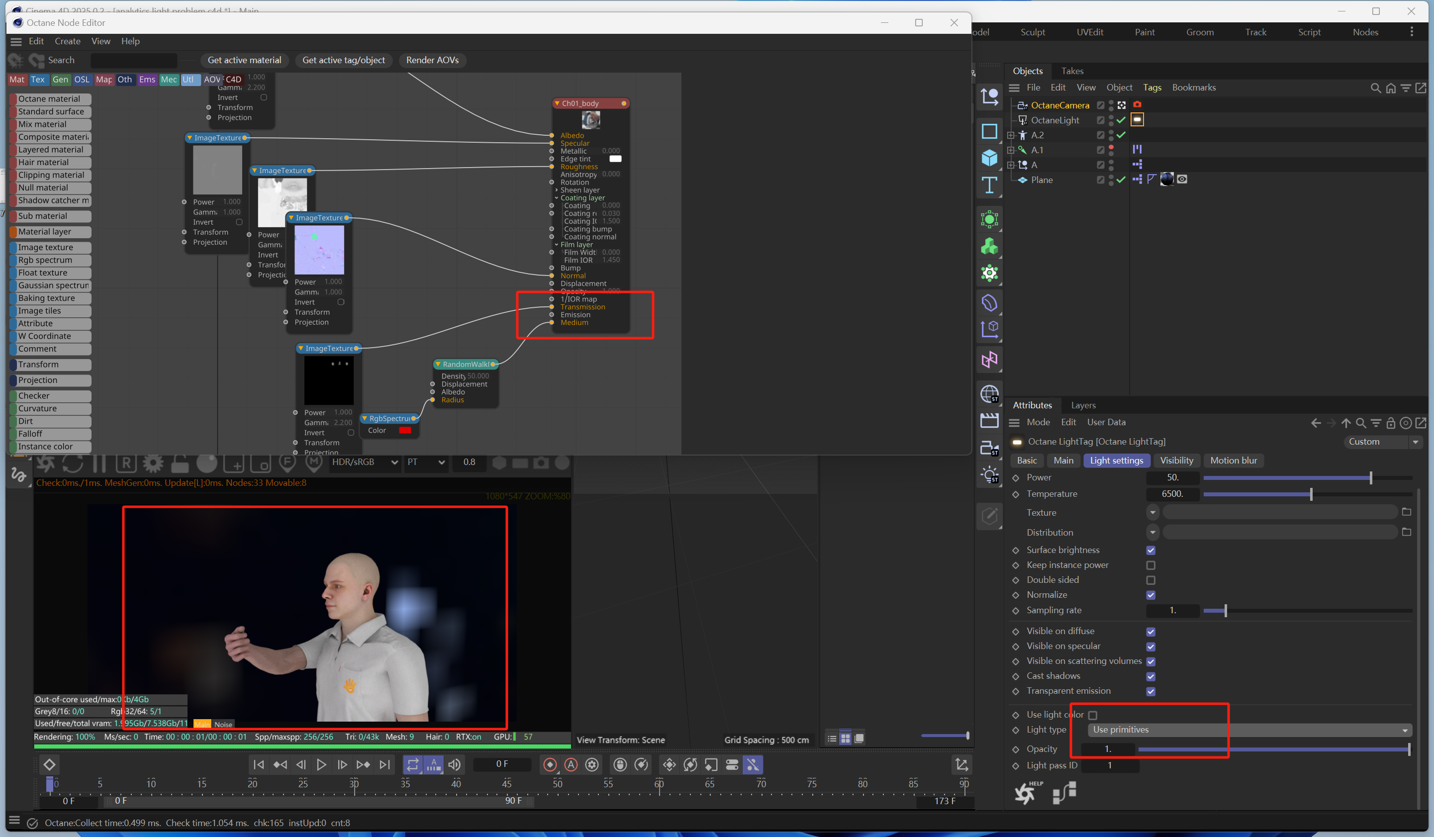

When I use analytics light and sss material together, strange things happen to the characters
But when I use primitive lights, or close the transmission channels, it goes back to normal
Why does this happen? The file is attached.

Yeah, I actually have a really, really big plane with texture emission material for the background, but why does scene scale affect analytic light ,not others?

Analytic lights are not compatible with transparent materials, sadly.

Yes, sorry, I was referring to analytic spot lights and fog. These elements are clipped by transparent surfaces.

skientia wrote:Project scale and asset-level scaling (not the whole project or "scene") do matter for several reasons and on different aspects.
• When it comes to light, Octane takes a relatively more physical approach, than let's say Cycles, where scale changes the "emission output" unless the corresponding checkboxes are enabled to keep it constant. This applies to any light in Octane.
• When it comes to shading, a wrong unit or inappropriately scaled asset will result in "inappropriate calculations" of refraction, SSS (radius is based on the scale), etc.
• Another reason at "kernel level" is Ray Epsilon, not much pertinent here but worth mentioning.
Ensuring the scale is appropriately set is one less aspect to worry about, one less thing to trouble solve in case of rendering issues.
